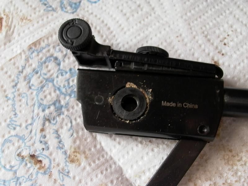

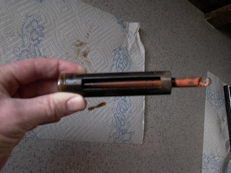

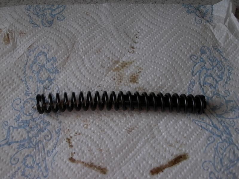

So I get the Stoeger home and play with it a little, it's not really a English quality gun, kinda gritty feeling, but short and easy to cock. The wood stock is just some wood from China with the paint/stain that a lot come with. The bluing look good over all and it has a metal trigger with plastic guard. The barrel joint feels tight and used a steel ball detent, breach and seal were good but the trigger feels mushy. The open sights seemed good and the front has a hood which all should have. The X3 can de-cock so after working the barrel a few times and feeling all the grittiness I got the screw driver out and tore into it. This thing is a piece of cake to tear apart after dealing with Trail XL and Hatsan 125, this is nothing, spring compressor is your thumb. So I remove the trigger block assembly after the screw and retaining pin. You have to remove the barrel to get the cocking linkage out of the chamber, pivot screw and keeper screw which is nice. The sear is several plates pinned together like a lot of China guns and the piston looks like a shrunken down B26. The inside was nasty, I don't know if they use rusty grease or some type of copper based anti seize but it's not good. Pulled all the parts out and cleaned them up, the seal actually looked ok once cleaned up and was pliable so I used it. However....I checked it against a Trail NP seal, looks like the same thing so that's a option if I ever needed one. I de-burred everything and cleaned up the spring ends where they were cut, ends were already sanded flat. The cocking slot is really jagged, spent a lot of time on it. As you can see the spring has a little bow in it, the rear has a spring guide so it does keep it straight when assembled. It is real easy to cock, the spring has a little bow to it so I added a almost 3/16 shim inside the piston, about the diameter of the spring wire. Lubed it all up and put it back together, I cleaned the trigger up a little but didn't really mess with it to much. I took it out this morning and ran it across the Chrony with some Crosman pellets. Some Stoegers have had breach issues and pellet seating, this one didn't, it was finished just fine. I put a compact 4x Cp scope on and it looks at home on the small gun I shot about 25 or so pellets then took some readings, average was 480 fps for 10 shots with a ES of 22 +/- fps. I guess when it only has a chamber that long it isn't to bad and it's still nothing to cock. The shot cycle is more than a 760 pump but nothing that I would think would bother most kids. Shooting at a piece of wafer board at 20 ft it will sink a pointed pellet about flush. Crosman Wadcutters and Destroyers about half a pellet deep, some of the light Daisy wadcutters bounced off, I don't use them anyway. I think he will be ok with it and I don't have to listen to clack clack clack clack clack and wait for 8-10 pumps, for what and where he's shooting I think it will do just fine. I'll get a pic of the whole gun as soon as the camera charges.
Spring
Piston
Breach and pivot bushings

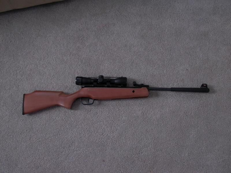

X3 with CP 4x compact scope

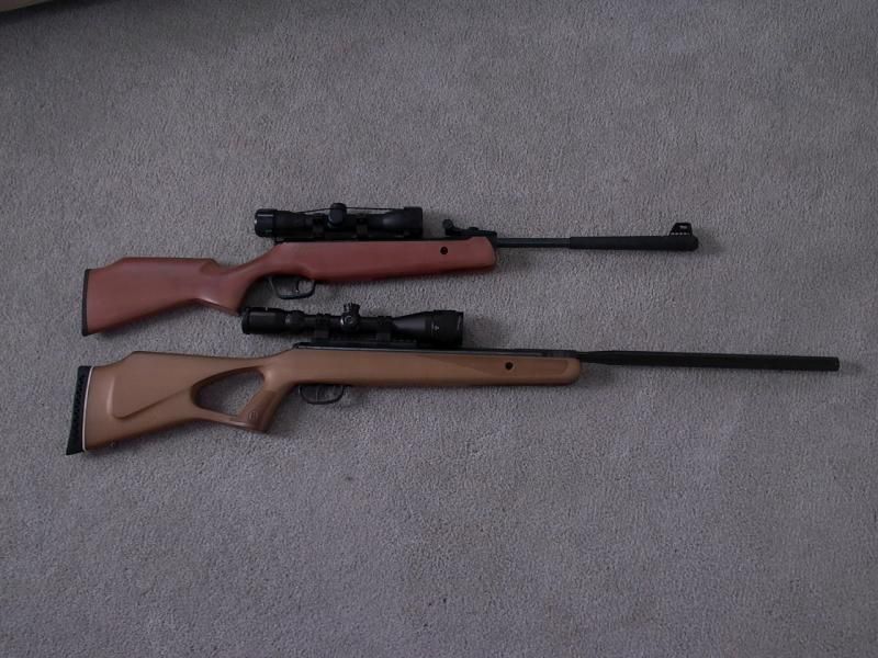

X3 vs Trail NP
X3 vs Hatsan 125 Sniper
