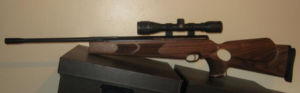

Well I guess the rats are going to safe for a few days until I get my rifle fixed I was adjusting the trigger and I got it too light. I knew it was on the edge and had hold to the barrel but when I reached for a pellet it let loose. It didn't bend it bad but it's bad enough. Maybe the barrel can be fixed maybe not. I'm going to send it to Rick Eutsler and I may have him clean it up and go over it while it's there. On the bright side I'll probably get a better rifle out of the deal. On the down side it's a hard expensive lesson learned. When you are messing with the Quatro trigger be careful because you can get it too light and it can cause it to let loose.I may just have to go buy that Benjamin 392 Bryan
Quote from: bbv13 on April 07, 2013, 03:41:06 PMWell I guess the rats are going to safe for a few days until I get my rifle fixed I was adjusting the trigger and I got it too light. I knew it was on the edge and had hold to the barrel but when I reached for a pellet it let loose. It didn't bend it bad but it's bad enough. Maybe the barrel can be fixed maybe not. I'm going to send it to Rick Eutsler and I may have him clean it up and go over it while it's there. On the bright side I'll probably get a better rifle out of the deal. On the down side it's a hard expensive lesson learned. When you are messing with the Quatro trigger be careful because you can get it too light and it can cause it to let loose.I may just have to go buy that Benjamin 392 BryanWell......I use this rig to bend my R9 barrel so the point of impact is close to the aim point at 30 yards after optically centering the scope....... Perhaps a similar setup would work for you.
