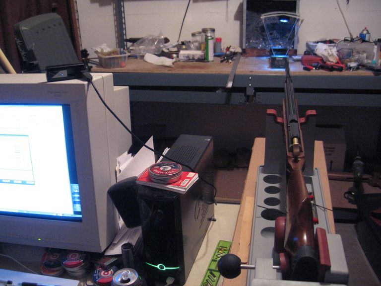

Have my F1 Chrony set up on my work bench with my duct seal trap behind it. Three led puck lights are velcroed to the diffusers for constant lighting. With my B51 in a Tipton Gun Vise, I place a level on top of the gun and when level, lock it into place. This is on my desk right next to my computer and places the muzzle approximately 3 feet from the chrony. Very repeatable. Using Chairgun's Statistics program, all I have to do is load, shoot, enter the numbers into the program, and repeat.

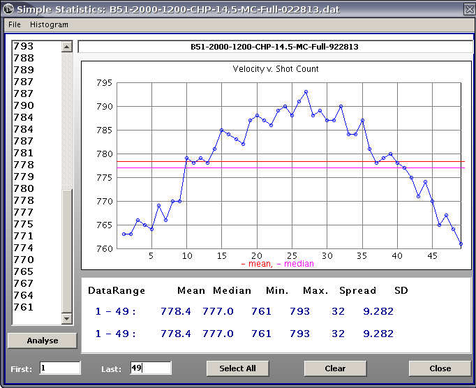

Anyway, starting at 2,000 PSI, I fired 49 shots (lost count) and ended at 1,200 PSI with the following results.
Not bad, 49 shots with a spread of 32 fps and just under 20 FPE.

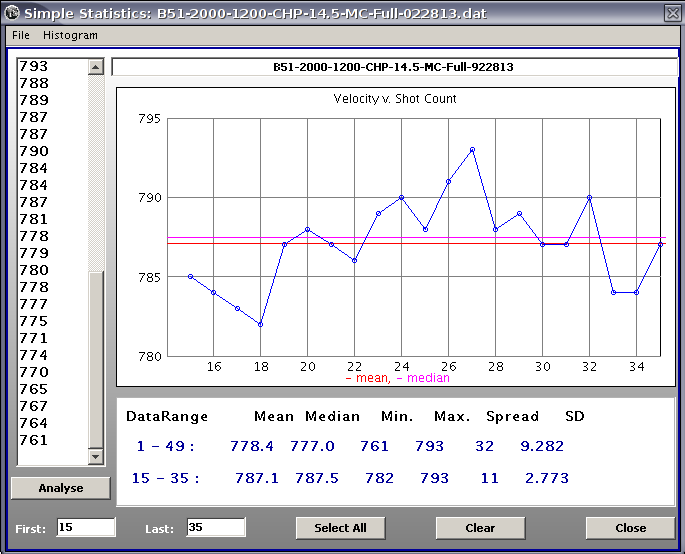

Within this string there are 30 shots with only a 15 fps spread
and better yet a 20 shot string with an 11 fps spread.
Should be able to find the start point for that 20 shot string without too much trouble. Sure wish there was an on board gauge to make things easier.
