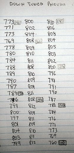

Some raw data. Just wondering how others would divide this.
.177 Pneuma being tuned for 12 foot pounds (using 8.4gr. pellets in this string). Not real efficient (yet) but am working on that.
60 shots with pressures occasionally added in (circled) along the way.
I’ll admit, that for goofing around the 20-30yard back yard, all 60 shots will work for hammering plinking targets, paintballs, etc.
But what spot would you decide (at this current adjustments) would be “sweet”.

Re: Is my methodology to calculate the "sweet spot" right?
February 27, 2013, 06:15:48 PM »
The whole enchilada looks sweet to me. If you must have a curve, throw out the first eight shots and the last eight shots, then you would have a double dipped in chocolate sweet shooter.
February 27, 2013, 09:15:38 PM »
As a pump filler, realized that filling all the way up and shooting 60 "pretty good" shots, is pretty much the same as TWICE as much effort as filling to 160 and shooting to 130bar TWICE.
So as i have the control, would rather fill twice and get 60 shots inside of 15fps than fill once and get 60 shots inside of 40fps.
Until I get the final setting worked out, will be filling this one to 165 BAR and refilling at 125. That's only about 30-33 shots, but it makes me feel better to know that any miss is due to ME rather than some change in velocity.
