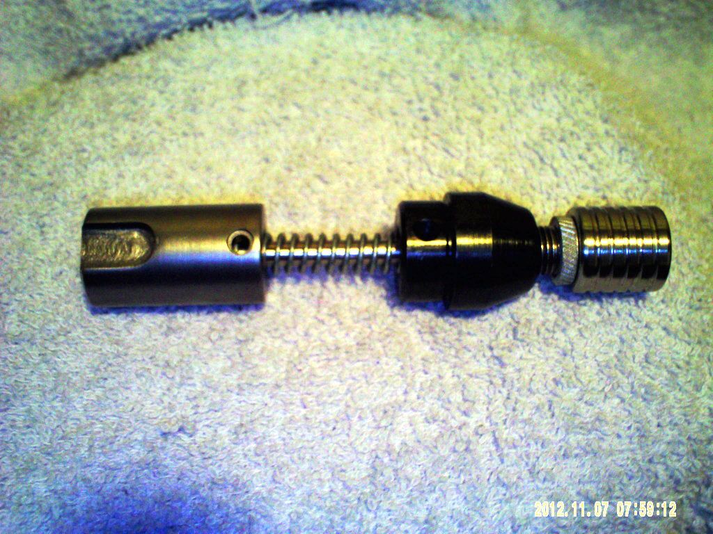

Can i do a BStaly mod on my Disco with stock hammer and spring?

Very difficult, you will have to use shims to get the O-ring stack just right, which will require pulling down the gun every time.... That is why people use the Challenger/PRod hammer.... Stock spring will work with either hammer....
The bstaley mod is great for detuning a gun.... but it won't work miracles at close to stock power levels unless you mod the gun to well above stock power to start with, and then you can get back close to stock power after detuning with the O-ring stack....
