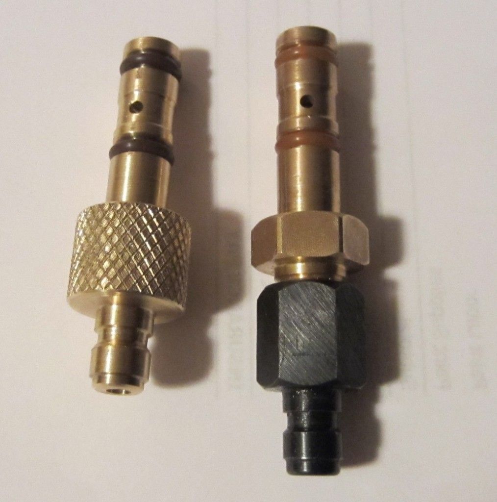

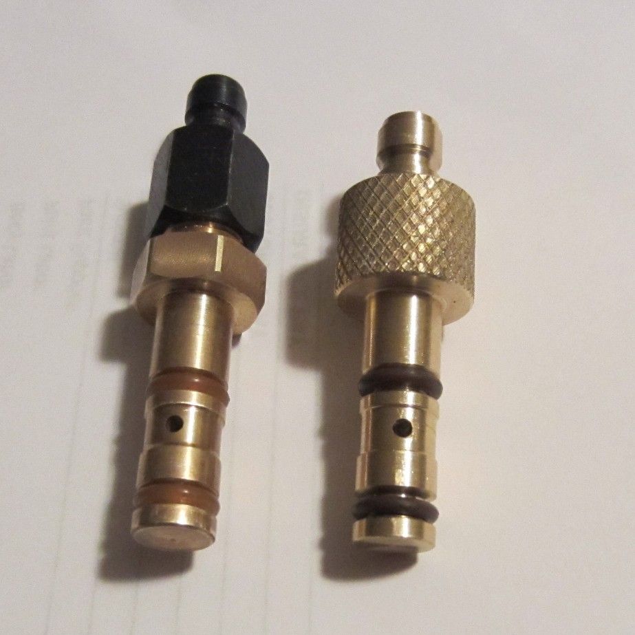

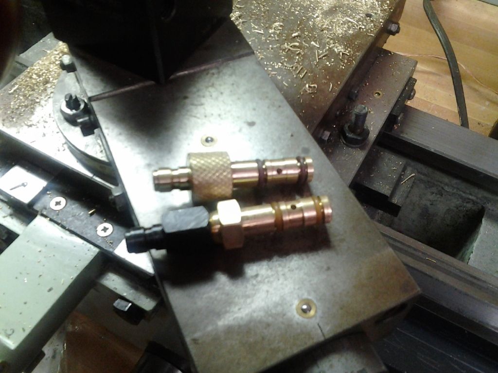

I had to make a probe quick fill for the falcon as it was the old style 1/8 bsp fitting as standard and made a sling swivel to fit on the air tube
Both parts now anodized black .
