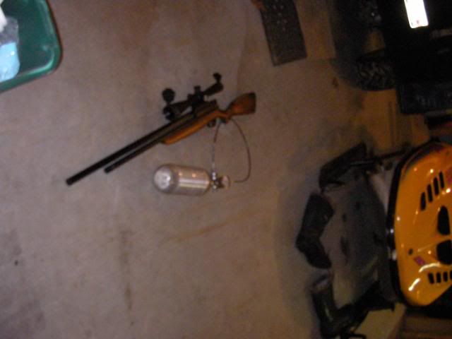

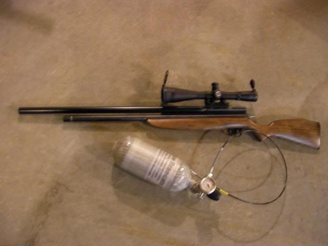

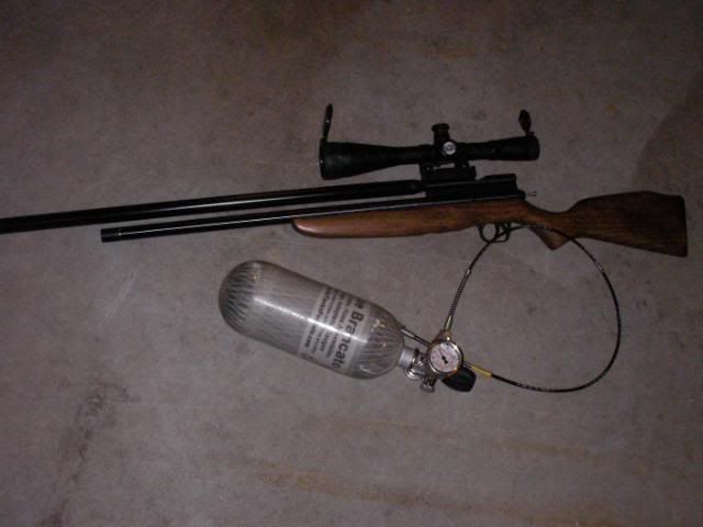

Ok well this project has taken longer to complete due to my wanting to torque too hard on the Stock lug and stripped it and had to wait for crosman to send me another one
But It is done and shooting very well
the specs
Benjamin Discovery in .22 cal
Scope is a Vector Raptor 4-14 x 50 Sidewheel
http://www.airscopes.com/Zen/index.php?main_page=product_info&cPath=1_4&products_id=1&zenid=e4qis856qluqde2rti25hvhlu0

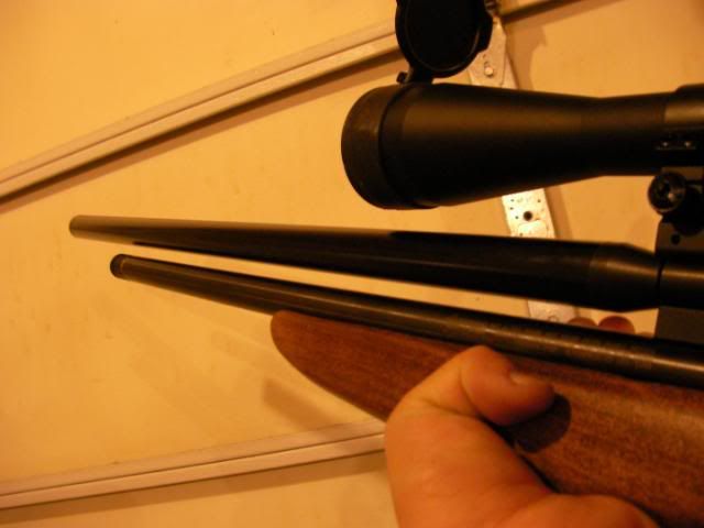

the Shroud is a Rpy Kasten Special it is Full length and This thing makes the gun sound like a Gerble chewing a peanut!

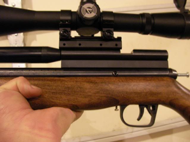

The breech riser is from @@ss%% guns and is the 1/2 in I probably could have got away with their 1/4 inch riser but Better safe than sorry.
I did polish the trigger sears and also Lighted the Trigger spring
The Valve I modded my self
I am going to mess with the power adjuster tomorrow but here is the string without the Adjuster installed and the Pellets used were JSB 18 grainers
I shot it at 30 yards and Got a 10 shot ragged group using my snowmobile as a rest.
here is the string shot at 3 feet from muzzle with a 2100 PSI fill 41 shots
