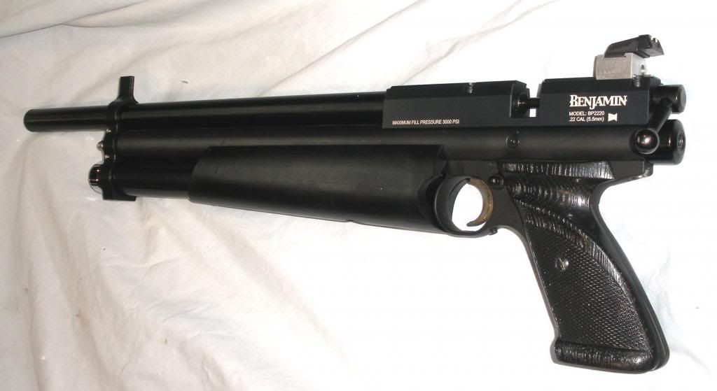

I have a friend of mine who is an excellent shot with a powder burner pistol and I introduced him to the Marauder pistol, with a little cheap laser on it. He fell in love with the pistol, but not the laser. He asked me, "Why don't you put some real sights on this thing and let me try it again."

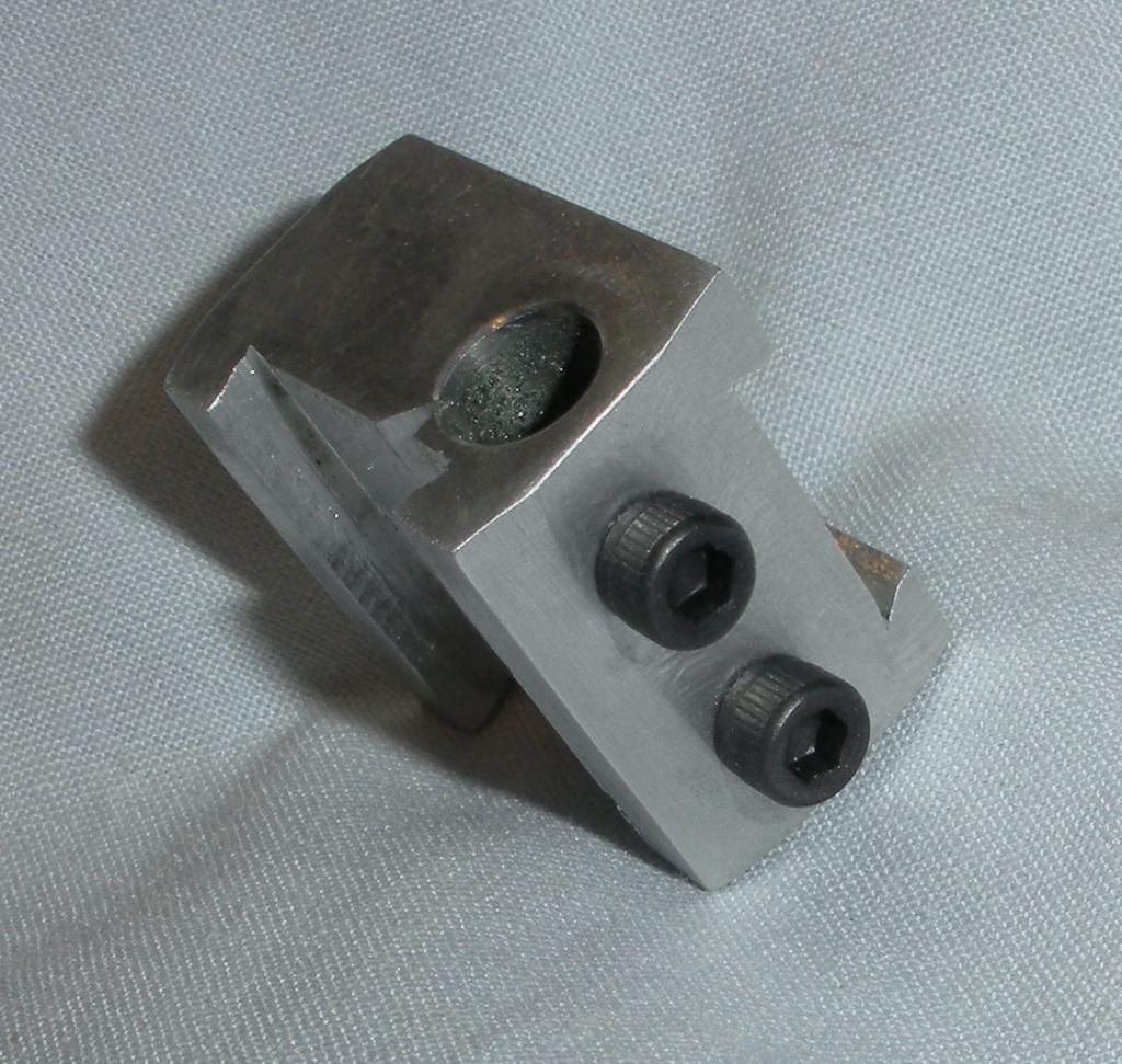

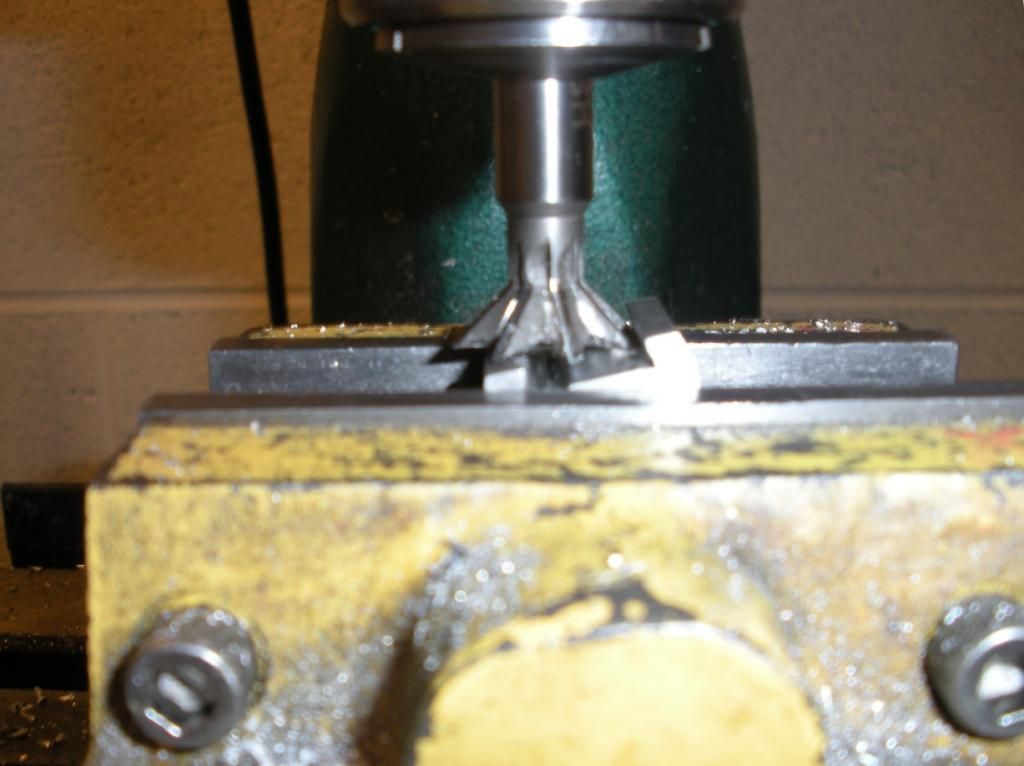

I already had the front sight blade for the P-rod double and had a nice rear sight from a trade, so I made a little riser block to be able to see past the tall circular magazine. It really works! Shooting side by side with my buddy shows me I have a long way to go with my pistol skills, LOL.

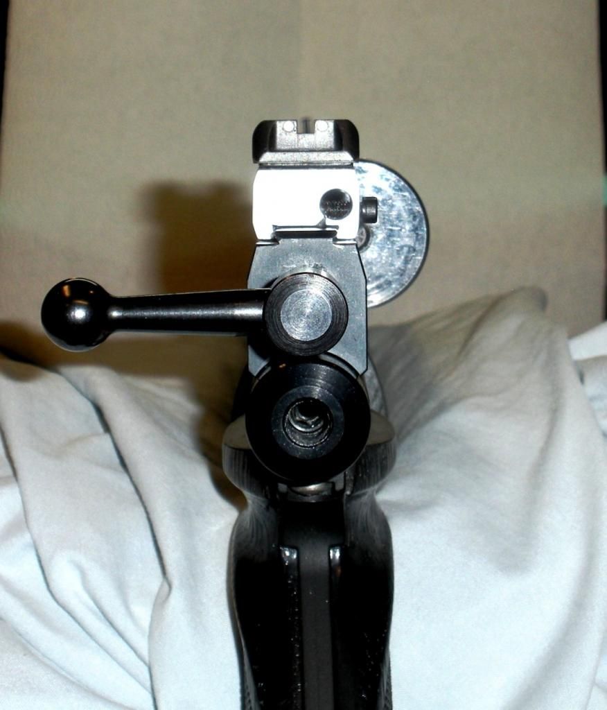

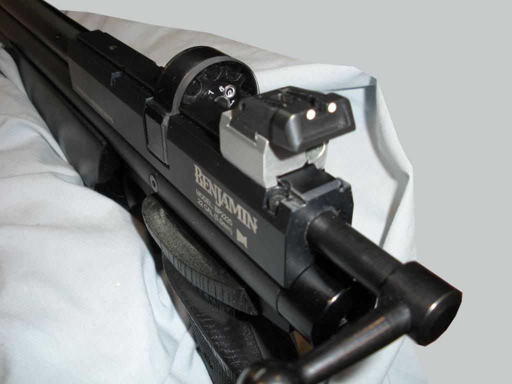

You can see the blade in the notch. The picture is fuzzy, like my vision.
The sights are high enough so that the circular mag is not distracting.
Detail of the riser and Crosman LPA mims sight. There is plenty of windage and elevation adjustment.

Lloyd that is very nice. The long sight radius probably makes it exceptionally accurate at ranges that are normally outside pcp pistols, if you can hold it out there. I'd bet it would make a great fast reaction carbine for tight woods. I think you may have a marketable item there.

Very cool. Whenever I remove the scope to work on my pistol/carbine always I shoulder and aim down the length of it, and think of how neat it would be to use open sights.
