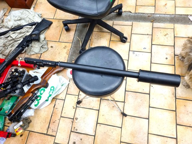

Came to dig into the setup with the banjo and so forth a little deeper.
Cut the window for added throw on the receiver. Flattened the banjo, and will rework that even further. Played around with the fit between the steel nose piece and the plastic sleeve.. i dunno. I really do not, but will give that sleeve one more try.
The probe in turn, i believe iīll just make a fresh nose for it, then out of higher grade steel. The threads on that thing are worn, albeit the piece is new, and i feel the material used is just plain cheap. Thus a fresh nose out of higher grade steel iīd say is on the agenda.
The cutout on the probe for the ball bearing, might be splitting hairs but truth be told.. either that cutout needs to be moved a bit OR the new nose piece set at a different angle and as the nose piece will be anyways.. you get the idea.
On the barrel in turn. I believe itīs speced as on 1:18 and sans a choke. Have pushed a few pills through it and it does measure on the money at least. The drawback here is that it will turn an already rather long rifle even longer, by just shy of 20cm.
But. Iīll give it a go. 1:18 should support all the slug use iīll ever throw at it at least, being very well aware that thereīs those that feel 1:16 or even lower would be the ticket.
But again.
This is a pesting tool. Not a long range pcp bench piece.
As for that breech piece.. undecided on material yet. But.. brass? I guess?
Last Edit: December 01, 2024, 07:42:47 PM by Racing

Yeah. So enough of this bolt flip issue already. Opted to cut the probe at the joint where it changes dia, and took it from there. New nose out of SIS-2241 stainless, a "slight" difference vs the stock papier mache stuff. D*mn that stuff takes a bit to cut into.. That M3 hole for the banjo bolt..yeah. That banjo is on there now as were it welded in there.
In turn, yes. As you can see a slug pin. It works on the R-10 as long as kept short, and good for us it really doesnīt need all that much in that dept all said in the first place. So all good.
Spent the time needed to ensure 100% lockup as the banjo is pushed rearwards by firing pressure. As you can also see the banjo in case has had TWO of its "sides" made 90deg to each other and yes.. it works. Rather well at that. Thereīs a slight axial movement on the probe, and i have to shove it inwards to "unlock" the piece now. Not by much, but enough to ensure that as the probe is pushed rearwards upon firing itīs going nowhere.
Then @ RKR.
I took to really compare the two barrels today. The stocker is on 470mm as it turns out. In other words 18,5 inches. The Evanix barrel on 650mm, or 25,6 inches if you wish.
That the latter will hand increased exit speeds i guess is clear to all, but shoving pills through both of them the BSA barrel is no doubt more loose vs the Evanix one but..
Any appreciable choke on the BSA piece, no not really.
WTeff?
What iīm saying is that it seems theyīre both on 1:18 twist (sure looks very similar too as you look down both of them vs a light source) and where the Evanix barrel sure doesnīt sport any choke what so ever the one on the BSA barrel is very slight.
Could this be the reason iīve seen so differing results using slugs vs what you have? If so, why did this barrel leave BSA like this in the first place? Seems a bit.. "not in total control of QC" sorts of? Or?
Anyways.
I donīt mind making one off parts one yota, not at all, but there sure DOES need to be a purpose for them... and iīm starting to think that the goals iīve got in this case... an about 50cm barrel will work just as well as a 65cm one? End idea is to, no matter pill weight, keep beneath 1000fps. See no reason to push that what so ever.
Sure. Theyīll of course behave slightly different, no argument on that one, but that being said..? I sincerly DO find this a bit peculiar, i have to say (that there with the BSA barrel).
I guess what iīm saying is that iīll take to fabricating that breech piece to make the Evanix barrel fit the BSA... but REAL unsure as to if thatīs the route to take all said.
As stated, i had decent groupings using the BSA offering shooting slugs of various weights as well as heavier pellets.
Racing
Posts: 469
Real Name: Jesper
Re: BSA R-10, now what?
Reply #142 on:
December 03, 2024, 07:19:39 PM »
Unit is back up and running.
In essence at the same power level as previous, throwing 25,4īs @ 960.
Thing here is... i want to really take a sit and evaluate what itīll thrive on. Cause as a pesting tool iīd say weīre there.
Even managed to repair the busted mag to at least usable status, for now until replacements arrive.
Nah. On a whole iīd say weīre back on track. Unitīs doing what it should without any particular fuzz, and the mods pulled as far as bolt flip =100%.
Bolt doesnīt move at all upon firing.
Giving thought how to handle that there with the regulator in turn. For now it at least seems the thing does what it does fairly consistent.
If it happens that the thing shoots better using heavier pills i guess iīll have to reevaluate and take it from there. Actually had it setup to handle the scaly tails for tonight, but as we just got a cold streak.. not even the slightest sign of life through the thermal.
Itīs no doubt ready for action though.

Got a 22cal Reximex Daystar sporting a Huma running at approx 170bar spitting Knockouts doing that (on a smaller plenum than this R-10 though). That is a wonderful accurate piece of kit hands down. No shroud, just the moderator, but still rather silent in operation. WAY WAY WAY more so than anything store bought.
What iīm saying by that is that this no doubt can be pulled off, and i like my puffs SILENT. As in "Hollywood silent". Donīt wanna bother ANYONE when out doing what i do. Well, besides the rats that is of course.
Still got a few trix to pull as far as this R-10 and performance. When i go SSG in turn i will replace the Impact spring entirely and run a dual setup. Mainly as this hands smoother "progression" in my book cocking the piece.
One thing i did today on that note was bring out a larger buddy bottle, mainly just to compare really. One of the generic aluminium 250bar jobbies, when it struck me.. i can make this happen real fast.
All i need to do is turn an adapter from the BSA style thread to M18 generic standard and done deal. Then just reuse the entire BSA valve and so forth as is.
So..yeah. Thatīd double the capacity of this unit in one blow and if iīm to hop it up even more to make them 1050.. it is needed.
Hm.
Iīll keep you guys posted, you can take that to the bank.

Ok.
So the probe seal deal indeed was a thing. Brazed some material to the groove and recut it, indeed...
That done though, like me n RKR have been over previous, weīve sorts of learned over the yrs that that there thing with shroud diameter becomes more and more essential to keep noise at bay as power goes up.
Indeed the thing has been rather well behaved already where i was at but that being said thereīs of course always room for improvement.
As the stock shroud doubles as a sorts of moderator too that turns these export version R-10īs into something thatīs anything but compact anymore, and seeing that weīre after all talking a mere just shy of 500mm barrel it turns a bit silly really.
At least to my mind.
Of course the alteration of this coupled with the can out front and the larger bottle changes the looks of this thing, but truth be told as if to that being for better or for worse you guys tell me.
This thing is on a full 30mm diameter, leaving that itīs a decent 28mm within. All of a sudden that absolutely massive 60mm dia can out front doesnīt strike me as completely retarded anymore but that being said.. itīs all about performance FIRST right.
As itīs christmas after all i still havenīt had that 300bar carbon fibre bottle delivered, so youīll have to imagine that one. As you can clearly see though that "oh whatīs up with it being that tall" is all gone.
On the contrary, i guess due the more hefty dimensions of things mainly, itīs starting to strike at least me as downright compact?
If nothing else it at least IS different.
Uhu. Might be old news to some but thatīs how the thing sits. In other words thereīs STILL room to spare, now seeing that the shroud is on a full 30mm and the bottle a full 60mm.
I believe the CF bottle to show is on 61.. so no harm no foul.
On a whole the exhaust note of course changed. Thatīs to be expected, why itīs now more of a "thud" or "thump" if you wish. That snappiness is all gone and the exhaust note is no doubt more mellow and WAY lower in frequenzy.
Happy with that. Have to say.
Another thing i did as i had the thing apart this time out was to hand the barrel a real "deep clean" and did it EVER hold some dirt! As thereīs no o-ring to damage i went at it with a bronze brush n cleaner, followed by patches n cleaner.. then patches all dry.. thing was like it was never to turn clean!
It finally did though, happy with that too as it hands a fresh platform to start from.
Now to check things like ES and SD to evaluate the reg on there. Still the stock unit, just with polished belleville washers and what have you.
I reason as such that beyond 20fps ES.. and that thing is outta there..

Right.
So the unit is up and running again, performing to whatīs to be expected iīd say... and then some actually.
As for the use of an X-ring, well the chrono lever lies me thinks why.... *drumroll*...in practice it netted about zero really.
Iīve tried this last probe setup (read - probe seal) now using both X-ring as regular o-rings. A few insights on the matter iīd state is in order.. no doubt.
First up, that there with o-ring grooves sometimes is a bit more to take in than most believe, or even care about, i bet. A o-ring, seeing "our" applications, should never see a groove where the seal "goes tight" vs its groove.
Ie; an o or x ring that sports say 1.78mm material thickness can very well be installed into a 2mm wide groove. I tend to hand the seals and "end shake" around the 1/10mm mark or so. What i do is just grind HSS cutter steel to fit and take it from there. Something see.. to have a few lathes around is a wonderful thing
So chrono readings were about the same regardless if X or O ring. Might be the X-ring setup came to net a few fps but for sure not a difference appreciable enough to care about. Write it off as standard deviation if you wish.
However iīd state that the X-ring install is more "static" in as much that as either of the two rings are shoved into the breech they WILL compress, which is a desireable in this case i think.
That in practical terms boils down to that the X-ring (to those not in the loop, X-ring is sorts of like a square o-ring in essence), per default, will sport two "major diameters" when compressed where the regular o-ring will see only one.
But.
The prime question here, at least as i regard it, is if thereīs any appreciable performance differences between the two, in other words if the one seals better than the other for the application at hand, and on that one.. nope.
Caveat here is that it MIGHT be a different matter for differing loads.
Ie; i run them Knockout slugs just a smidge over 1000fps as is. It might very well be that any performance difference might come into effect as i use say 34 grain slugs @ the same muzzle speed?
But for now, where iīm set.. nope.
That i HAD a minor leak at the breech though is just to resign to. Exhaust note as well as amplitude (read - dB) had no doubt changed since i got this here with the probe seal handled.
The in turn now implement of that larger diameter shroud stuffed with filler... in turn coupled with a diffusor on a tighter through hole, that of course cuts down on the job the actual moderator has to do.
In simpler terms, the current setup is more effective at what it does. The gun has turned more quiet in use in short.
So far i havenīt gotten around to sight the thing in yet, hope to adress that come tomorrow. In other words as of yet no idea how this new shroud n moderator setup affects accuracy - if at all.

So have I, and FWIW to be noted this does increase poppet weight slightly.
TBH and blunt though iīve done a fair share of these 2mm setups by now and this is the first time iīve encountered an issue. At all.
To be noted is that the BSA was actually on a 1.8mm shank as this happend.
Have redone to 2mm flat since.
