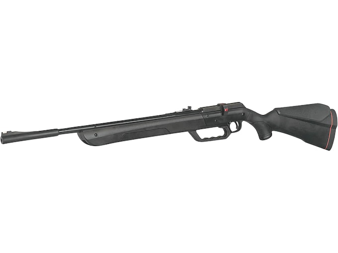

So I got a gamo swarm whisper mach 1 (brand new) in .22 and a prowler in .22 (pretty old).I believe my mach 1 is around the same power as the prowler, although I just think when I got it (like 1 week ago) it was way stronger.The mach 1 is like 20-22 fpe and the prowler is maybe at 14 to 15 (I DONT KNOW WHAT MY FPE IS , THATS WHAT I WOULD PRESUME!). I just cant shake the feeling I could've gotten a lemon or theres already a problem. Theres tests I do with my mach 1 now that I feel it used to do better like a week ago.I put a big fanta bottle, like the general one, and fill it with water. It goes through but doesn't have power to puncture the other one. I have the lids off btw. Is that normal? How does your airgun preform on that.I'm kinda scared
Quote from: rmDaffle on January 03, 2025, 10:01:26 PMSo I got a gamo swarm whisper mach 1 (brand new) in .22 and a prowler in .22 (pretty old).I believe my mach 1 is around the same power as the prowler, although I just think when I got it (like 1 week ago) it was way stronger.The mach 1 is like 20-22 fpe and the prowler is maybe at 14 to 15 (I DONT KNOW WHAT MY FPE IS , THATS WHAT I WOULD PRESUME!). I just cant shake the feeling I could've gotten a lemon or theres already a problem. Theres tests I do with my mach 1 now that I feel it used to do better like a week ago.I put a big fanta bottle, like the general one, and fill it with water. It goes through but doesn't have power to puncture the other one. I have the lids off btw. Is that normal? How does your airgun preform on that.I'm kinda scaredMy Prowler shoots around 16fpe. I don't have a Mach1 Gamo but they appear to be rated 22 fpe BY Gamo. IMO that is likely MAX as most manufacturers use overly optimistic specs. Realistically the Mach1 Gamo will chronograph between 18-20 fpe. You will NEED to use a chronograph to measure velocity and calculate fpe.The difference between 16 and 18 fpe will be very subtle unless you use a chronograph.Many NEW rifles will have excess factory lube. I believe this is done to prevent RUST during extended duration shipping and/or warehouse storage. That factory lube will BURN adding velocity to pellets during the initial break-in period. That could be 50 pellets up to 1000 depending on the amount of factory grease.What I typically see in "fresh springers" is 2-6 shots of EXCESSIVE grease burning which is VERY LOUD and VERY SMOKEY. Much of the LOUDNESS is the pellet going SUPERSONIC like the CRACK of a bullwhip. Some folks call that detonation and it is a HARD SHOCK to the internal parts. A few shots like that may not cause damage but MANY shots like that will damage the internal parts.After a few supersonic rounds the "fuel" (grease) begins to burn away more slowly. This is commonly referred to as "dieseling". Rifle will be shooting "hot" but not supersonic. You can SEE and SMELL this phase. Little wisps of smoke lingering around the muzzle or breech and the acrid odor of burnt oil should be obvious.Both the smoke and the odor will dissipate over time. The pellet velocity will gradually go down and then plateau around where the rifle SHOULD be shooting for a long time.At that point there is no extra fuel to burn and the rifle is just using compressed air to launch the pellet.I think your Prowler is where is should be and your Gamo may be dieseling down to where it should be.Chronograph data is the best way to determine if your rifles are healthy or not.
Did you clean the barrel of the new gun before shooting it? Was there any sign of dieseling or detonation? A new gun will frequently have residual oils and "stuff" left over from the manufacturing process. If there was detonation it would have given the pellet more power until the barrel was clear. Compare the power of the two guns now. Shoot it awhile then compare them again. They should be fairly close.
