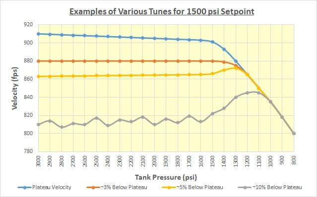

The gun starts working properly at about 2900 psi tank pressure.... Above that your velocity is increasing.... Check out the grey line on this chart.... The bump in your velocity is however occurring below 2900 psi tank pressure....You should either increase the hammer strike (which will increase the velocity and decrease shot count).... or decrease the setpoint pressure (which will decease power and increase shots, which doesn't seem desirable in your case).... Aim for the yellow or orange lines....Bob
