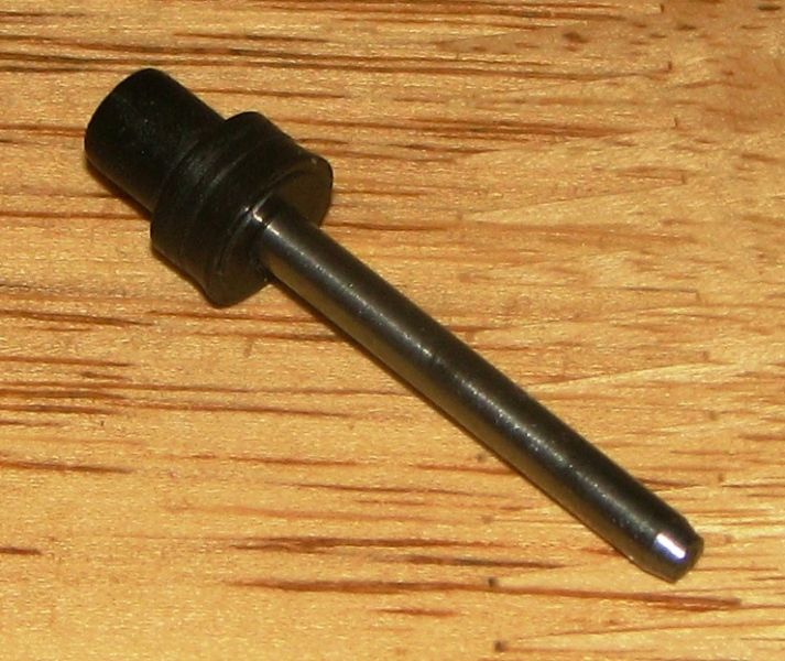

Yep, exactly, and if no bronze is available for you, fit a brass tube the size needed to be a slip fit for the stem. SS, especially 303-304 316 are very bad about galling as you are seeing here. Fully polishing the stem will help a LOT!!!Knife
304 SS is fairly tough stuff and the poppet pin needs to be HARD ground and polished DRILL ROD as to not gall sliding within the body.If or when you have similar hardness materials sliding by one another they wont move smoothly requiring a high viscous lubricant to be present.SADLY in a high pressure system as a PCP valve such lubrication will be BLOWN right out.A suggestion ... Take the valve body and ream out the poppet pin area to accept a Bronze sleeve to be the bearing surface against the pin material your currently using.just a suggestion ...
Something hard, and something harder, with minimum clearance, and light lube does quite well. It makes things like head squareness important to sealing well enough to pump it up from zero. If I could I wold run for about .0002 consistent, round on round clearance. That is about a mile compared to the head of a diesel injection pump though.cheers,Douglas
I had made a knock open valve out of 304 SS. and used a 1/8" alloy steel dowel pin for the valve stem, I thought that would be a good combination of materials. The valve stem hole was reamed to 1/8" and the combination felt very slick. Well it turned out that the SS. was depositing on the stem and the valve stem was seizing intermittently. So I reamed the valve stem hole one thousandth over size. This a valve I was using a heavy valve return spring on trying to control valve bounce. I had the valve set up in a vise and I was pressing the valve stem in a couple of times to see how it felt, and noticed that there was a jolt, and then the stem went forward, there was two motions taking place before the valve opened instead of one. This was do to the one thousandth over stem hole, the stem was moving sideways before moving forward. There was big drop in velocity with the one thousandth over hole, due to the two motions.
Hi All, Yes, I did put a bronze sleeve in the valve reamed to exactly 1/8" with a 1/8" alloy steel dowel pin valve stem, and got an increase in velocity. When the hammer struck the valve stem with the gun under pressure, the .001 valve stem clearance let the valve stem move sideways, ( robbing some of the hammer energy, before moving forward).
