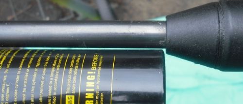

Barrel contact on a QB79.

Making the barrel stable/shooting well.
THIS IS NOT something most rifles need....but this one did resond well to CONTACT between the barrel and the tank.
Normally we'd not think that could help....but then I thought on it and experimented with soft and hard contact points.

Made an aluminium "ring".
Idea was that a radius cut on the bottom of the ring would pretty well self-center the barrel to the tank. Knock it, nudge it,and it's going to want to go back to the matching radius of the tank.
DSCN2047
by
Robert Dean
, on Flickr
Implimetation was simple...put the ring on the barrel, shoot the rifle a few times for it to find it's natrual set point, marke it, glue it to JUST THE BARREL.
The radius cut seems to self center. It'snot attached to the tank,so the barrelcan slide in and out for expansion/contraction issues, and it provides a bit of "Up" tension when the tank is pressurized to the rifle.
I did "jack leg" test it for up tension by putting a dollar bill between the two, and judging the effort to pull it free.
With the tank as "zero", the tension was in ounces.
With the tank filled and the tube pressurized, the effort to pull the bill free was about 2-2 1/2 pounds.
What that means in actual "up"force, I really don't know as it is in "dollar bill slide force" numbers....but it feels the same from a 3K fill down to 850psi (the running pressure of the regulated HPA tank)
Likely helps that the barrel is a shortened QB barrel; there just isn't a whole lot of barrel (about 1 1/3") sticking out past the end of the HPA tank(mostly covered by that fat LDC).

The "pig" without it's ring,,,,wasn't touching...so will call that: Free-float + Band.
THe same "pig" with the shown "ring"...we'll call that: "ring" and band.

The difference (although I need some "left" windage):

I actually ran 3 tests,but there was no differnce beteen no barrel band and no ring and +barrel band and no ring, although I don't think that the fully free foated barrel (no band and no ring) would keep it's zero with even a moderate "knock".
So there you have it....one old gun's revival. It's not the most accurate, I think of the "pig"as "steampunk-ugly", but it will chug along year after year.l

Robert!!
I would think 3 orings could replace this white bit if ever it fail you... It has made it more accurate for sure...
The level of power the rifle provide isn't enough to rip through this bit for awhile …..
