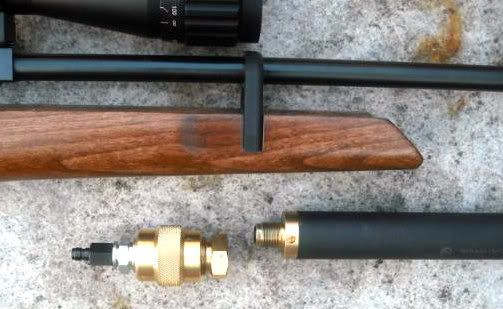

Just curious if anyone has cracked opened up the tube on one of these babies. I have a gauge leak and was told there is an O-ring on the bottom of the gauge that can be replaced. The end caps of this tube have two holes drilled in them for what I believe is the use of a spanner type wrench to unscrew the caps. I can't get mine to budge but confess, I do not have a specialized spanner wrench either. Anybody ever removed these caps? If so...tell me how.Thanks AOT!!!SAFE & Happy Shooting!!!!Dave
Will try some heat. I have some strap wrenches also....will give them a work out.LOLThanks for the suggestions. Guess I'm just weak.
Quote from: ezman604 on March 21, 2019, 11:33:51 AMJust curious if anyone has cracked opened up the tube on one of these babies. I have a gauge leak and was told there is an O-ring on the bottom of the gauge that can be replaced. The end caps of this tube have two holes drilled in them for what I believe is the use of a spanner type wrench to unscrew the caps. I can't get mine to budge but confess, I do not have a specialized spanner wrench either. Anybody ever removed these caps? If so...tell me how.Thanks AOT!!!SAFE & Happy Shooting!!!!Dave DEz if it anything like the end cap on my Rainstorms if you use a heat gun to heat the end cap (Locktite) then use a piece of an old leather belt wrapped around the end cap and large channel lock water pump pliers it should spin off easily. Every PCP that I have removed the end cap had some kind of thread lock compound on it. Even if it is just an old age thing just from not being disturbed the heat will help to break or soften the bond.
