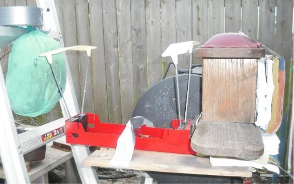

Am looking for the orginal post...it's been like 7 years ago....
Crude Rube Goldberg type system to get an idea of energy deposited in a set thickness of test media (in this case,soaking wet news print type paper). Tried different calibers/pellets/energy levels/ and thickness of test media (the blow is actually a "thick" test).
Idea was to shoot the system without the wooden box-frame holding the media to get the velocity (pellets impacting the green bag backstop dangling from the ladder) to get the average velocity. Then put the test media box frame in place and do it again to get the velocity of the pellets after exit.
From the average of those numbers, could figure out how much energy was deposited in the test media.
FOOT NOTE (wirth reading is you want to try this):
I did start the test with two chrongraphs, one ahead of the media and one behind the media.For COMAPARITIVE use, the slightl difference in distance wouldn't really matter as all the pellets tested had the same difference in distance.
BUT, about 90% of thw way though testing the calibers/rifles/pellets I wanted to test, one pellet just did not penetrate nearly as straight as I had hoped for....it took a dive somewhere in the thick media, missed the shielded front of the chronograph, but blew the back end of it to pieces.
So I ended the test with just one chronograph.
So do NOT bet that the pellets always penetrate in a stright line....they don't.
EDIT:
Still looking for the original....but do remeber that not too much unexpected was the result of all that.
With ROUND NOSED pellets that didn't deform/expand,was a pretty direct relation (inverse) between energy and setional density.
Was a pretty good (with some exceptions) inverse relationship between the pellet's BC and energy deposit.
Expanding pellets deposited the most.
In thin media (estimated pest bird thype thickness) often got more energy deposit with a 15 foot pound .177 Polymag than a 50 foot pound .25 RNL.
Last Edit: October 03, 2018, 07:46:59 PM by Ribbonstone

Wouldn't be nearly as easy to just cobble together as the above picture (which actuallly worked well).....but I'd avoid the sled and go with a pendulum with the test media to be penetrated as the striking point.
Yep...if I did the same test again, would use a shield BEHIND the test media to block any pellet that turned off courseinside the media.
