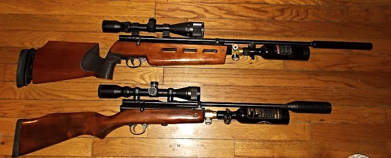

It appears that your group sizes are mostly affected by variance in fps. Accuracy wise it may be on par with the .177, but the .177 seems to hold together better due to less variance in fps over the course of a handful of shots.
Excellent review! I really enjoy mine and is a keeper to me. If there carried by someone with PayPal I will likely buy one in .22 as well as it's a fun gun and I'm very happy with the performance as well.
Quote from: makoda on March 15, 2018, 11:33:13 AMIt appears that your group sizes are mostly affected by variance in fps. Accuracy wise it may be on par with the .177, but the .177 seems to hold together better due to less variance in fps over the course of a handful of shots.I agree, to an extent. I want to take the shroud off and take a look at the barrel crown to rule that out, as I have a suspicion that this rifle has a rough crown, something common with many rifles targeted at the entry market. I will say shots 1, 2 and 10 do seem to be most affected by velocity differences. The 50cc cylinder I think is what is making this difficult to deal with HOWEVER, in the field, I'd just be comfortable knowing I can get 3-5 great shots, then know when i have to repump to keep riding that curve. Having the built in pump requires a different mindset than a traditional PCP to me.
To maintain the desired tank pressure and hopefully maintain a flat FPS, do you think pumping after every shot (maybe 1, 2 or 3 depending on power level)) will be better ?
Seems like a very versitale rifle indeed.
I got to play with mine today, pumping is a breeze, I prefer it to using a hand pump even. Found holding it like a pair of garden lopper shears pointed upwards, and use a scissors action , moving the pump handle and the gun stock equally works best for me.
