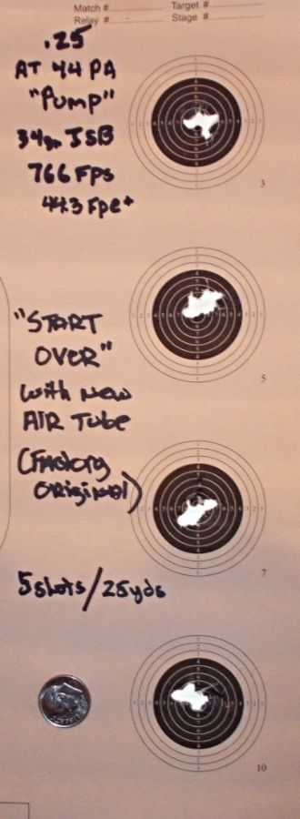

Previous testing showed this rifle, for whatever reasons, liked the 34gr. JSB's. As nothing else has shown this much affection for the pellets, may as well use them up in the rifle that does.
So I finally got around to actually chrograophing a full string (well...a full "useful" string).

WANT MORE POWER?
Certainly can crank it well above this energy level...and I have...but went back to near factory settings for the "hot" tube.
