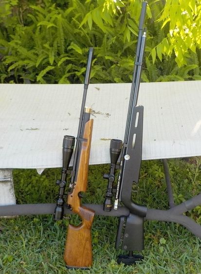

Last time I had them both out were both set for about 4.5-5.2 foot pounds (depending on the pellet)....either would make a POT full of shots (+100) at that setting.
Can certainly see there is a style and size difference. I've a .22 AA s200 from 2003 that is still working just fine, so the design isn't problem prone (although the folks who want to crank them up in power do seem to have more problems than the 12 foot pound or 5 foot pound shooters).
Unlike the previous post (one little bag on a patio table), took full beneifit of a front and rear rest on a bench.
Over the last couple of years, at least at the low end of power, really couldn't find an accuracy difference when shot on the same day (to at least try and get wind and lighting to be uniform). Pretty much know why 10meter shooting is mostly indoors, as I do think the rifles could do better...but those little puffs of wind you'd pretty much ignore at such short range do make a difference.
YOu might find this interresting about the AA 200T.
Just using the transfer port adjuster (the screw on the right side of the reciever), leaving the striker spring adjuster alone (so it runs well over about the same pressure range). Fractions at the top of each list is the transfer port setting starting at zero and backed out a fraction of a turn at a time.
Lists are velocites for the transfer port setting.
So basically, can just turn the strngle screw in until it stops (has a shape that stll lets air get past even at that setting) and have a 5 foot pound rifle...or out and have a 12 foot pound rifle. It's not "flip a switch" easy, but close to it.
Changing the Challenger requires a take down and transfer port swap....not even close to "quick change".
(As to why some settings had 2 as much velocity varation than others...I haven't a clue.)
