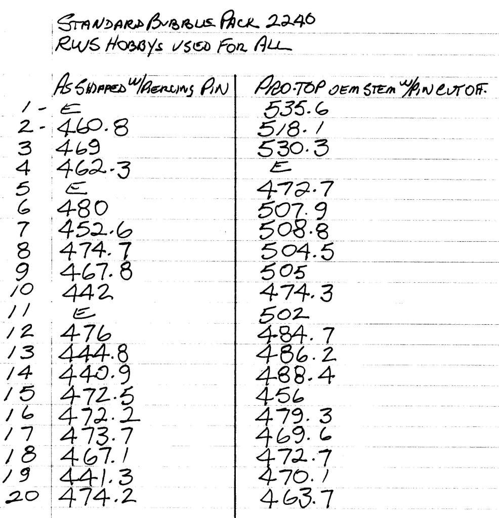

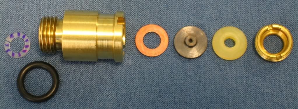

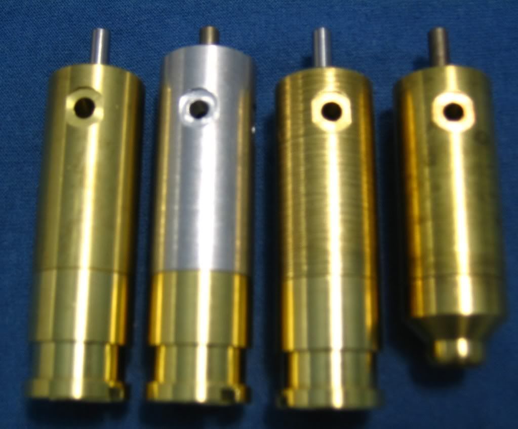

Yes the Pro-Top's are still around. And the Disco valve seat and stem combination do seal and work well at co2 pressures. I have found that Disco stems do not seal reliably in a 22xx valve body as the 22xx seats that I've seen usually have nicks and marks in them that usually only seal with a softer more compliant stem.For the folks that haven't seen a Pro-Top here are a few pic's.From the left Pro-Top on a Boss valve Disco valve ,22xx, and an OEM 22xxHere's what is in themLooking into the captured powerlet seal and piercing pinHere are some before and after chrony strings I did on a brand new bubbly pack 2240. All that was done was to cut the piercing pin off the OEM stem with a Dremel. These were done in about 68deg f basement no time taken between shots just loaded and shot. As can be seen the test pellets were Hobbies which will be a bit faster in both tests.
