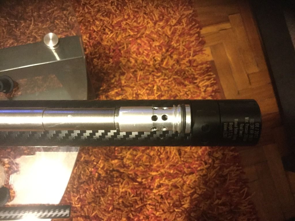

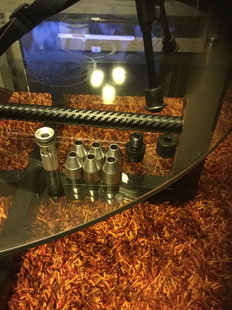

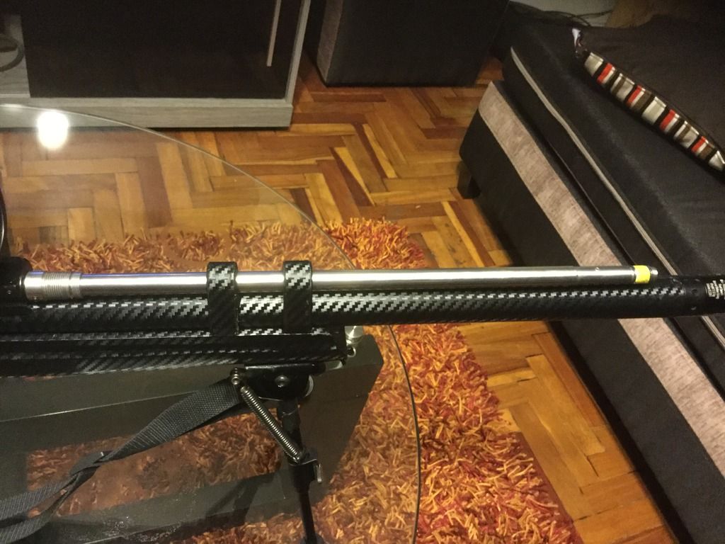

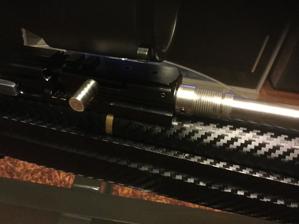

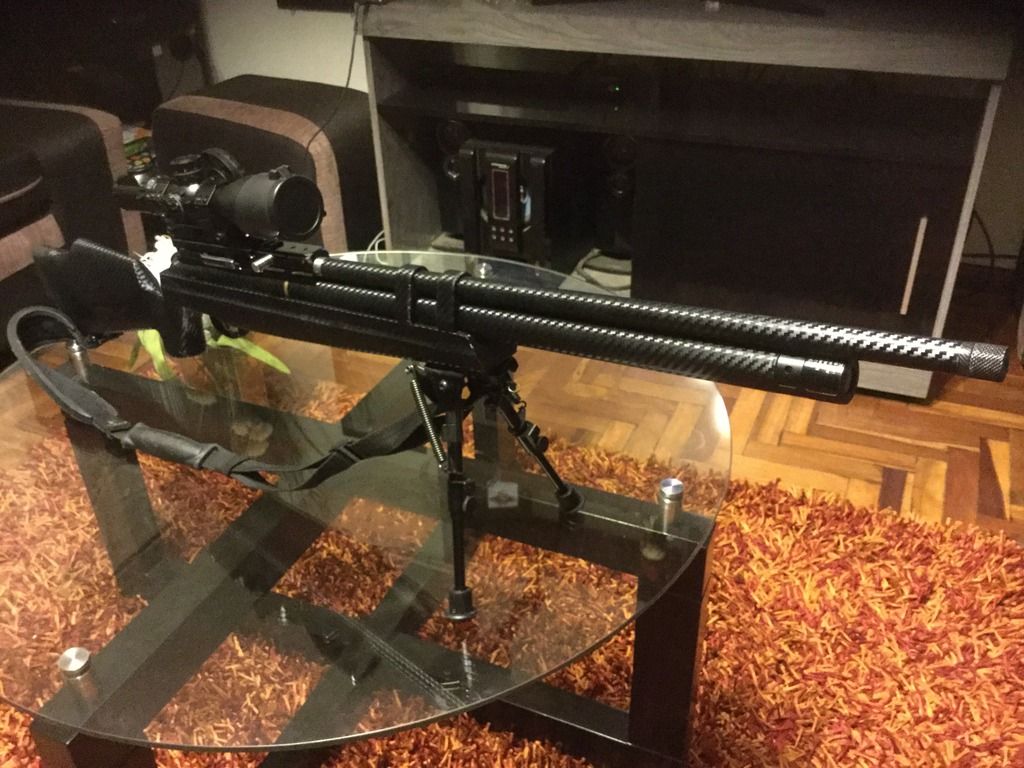

My AT44 was too loud after some power mods so I was producing 120+ db
Thats why I put a shroud on it... I prefer the shroud over the LDC 'cause I dont want
to make the gun larger. Put the shroud in a classic AT44W needs to change the barrel guides
a shroud mount over the barrel, some baffles, shroud tube and an air stripper (like mrod)
A bit of work but it was worth it
Here some photos:
Shroud parts
New barrel bands
Shroud mount over the barrel:
Internal air stripper:
Final assembly:
Regards
