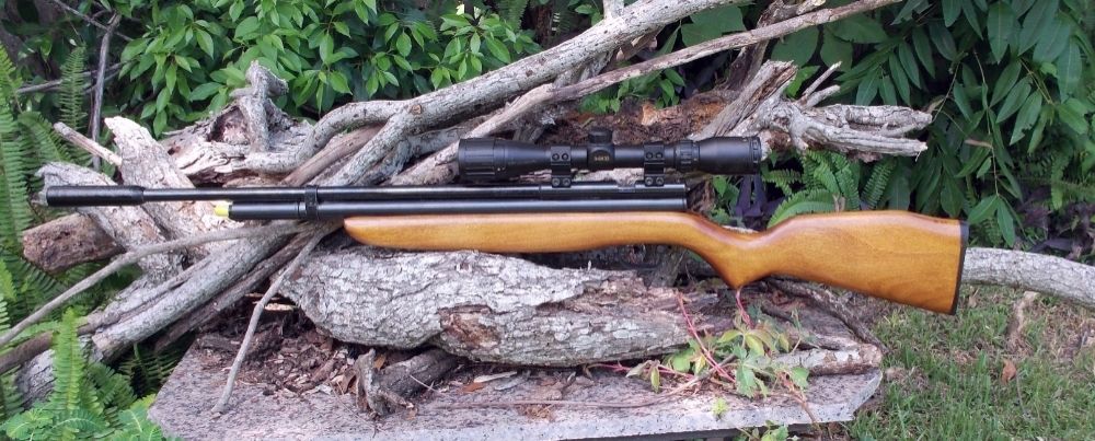

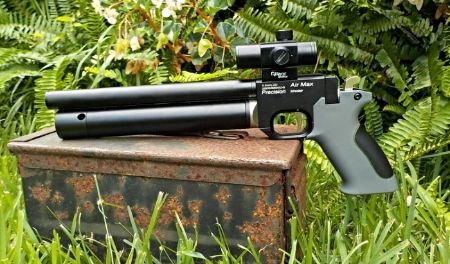

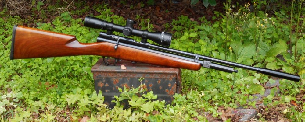

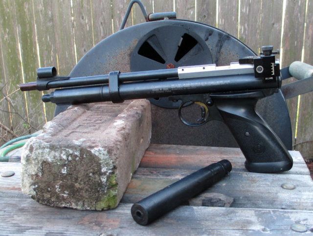

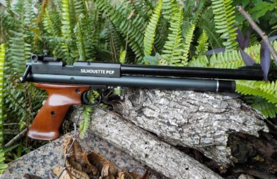

LEt me see....what airguns do I have with less than 80cc's of volume?
2260 HiPac (old version is a little bigger) = 75cc's
.177 / 2260 HiPac (newer version is a little smaller) = 72cc's
.22 Power Max pistol (REGULATED) = 68cc's
.22 P-rod = 65cc's
.177 QB78 HiPAc = 54-55cc's
.177 1701 Crosman = 45-46cc's
.177 2300 HiPAc pistol = 30-32cc's
(Can add in another 4 rifles under 140cc's)
Evidently I've found a use for the small air volumes when hunting, but generally limit the power output to whatever I can get with about 12-16 shots per fill (with good efficency).
Hunting is different from target shooting, plinking, varminting, or metal-critter-games. So long as you don't get side tracke3d by splattering cow-pies, shooting knot-holes, or generally goofing around, are NOT likely to get 12 good clean shots an afternoon.
