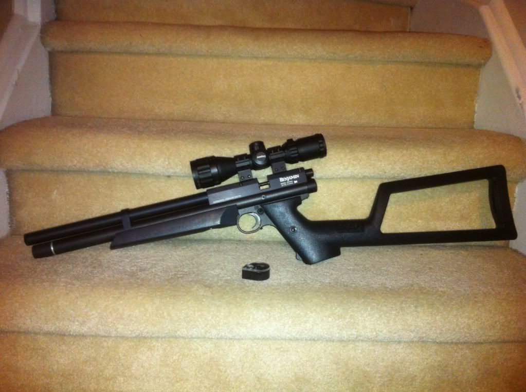

Hi its been awhile since I've been on here.
I finally got some time to sit down with the choney and try to tune the Mrod. I got this gun used so I am
not sure if was factory settings or not but it was set at h spring 4 turns in from all the way out and
h stroke 2 turns in and I was filling at 2500 lbs. and shooting down to 2000-1900. I was getting 25-30
shots. My shot strings would start out at 910 fps and end at about 850 fps with no curve at all. I am
using the ATeam guide to tuning with lots of air and pellets.

Hammer spring 3.75 turns in
Hammer stroke 3.5 turns in
TPort 2.75 turns open
I think I can tweek this more yet but what do you guys think?

Update:
I found out why I was having trouble getting back to the above string my hammer stroke
adjusting screw is moving. Even if you keep good records that will mess you up every time.
I think I got back to were I was but I am using a Lighter pellet cuz ran out of the CP heavy
so I am using cphp. the numbers are allot higher but I got that nice curve back.
40 shot string
#1 1073.32
#18 1142.51 high
#34 1091.71 4% as per Bob
#40 1071.71 low
TP wide open 4 ccw
hspring 3 1/5 cw
hstroke 3 2/3 cw
I don't think the setting's on my first post are correct. Dose any one know how to stop
the hammer stroke adjusting screw from moving? Thanks for any help.
Mark
