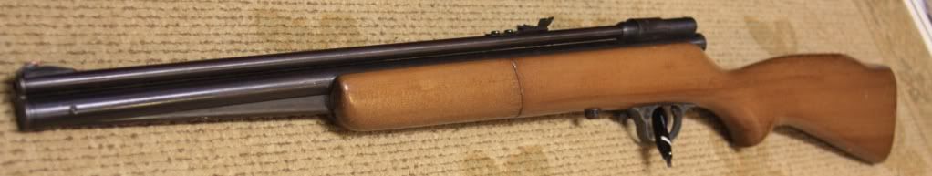

I'm getting a Crosman 1377 and I want to put a .22 barrel on it.
What do I need to do to make a 2240 barrel and breech fit on a 1377?

The 2240 barrel is too short for a 1377 - 8" vs. 10".... On the other hand, the breech is the same, only the bolt changes between the two calibers.... However, I would toss the plastic breech and get a steel one.... Purchase a 10" or 14" Crosman barrel in .22 cal and a steel breech c/w .22 cal bolt from Crosman....

Thank you.Just the info I needed.
Do you think Tim at Mac1 has the parts I need?
