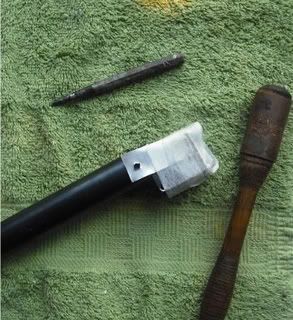

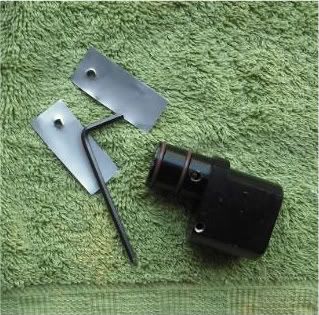

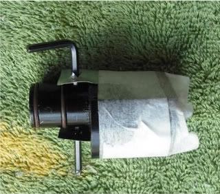

SO to make the screw locations "hillbilly easy" (still need care, but can make it more simple):
Lets assume you cut the tube (we'll get to length a bit later) so it has no threads (threads are weaker than un threaded sections). Have make it as falt and even as possible and have debured it inside and out.
OK...I cut two strips of Al. can.
Pucned them each with holes that were a tight fit to the mounting screws.
Ran a tight fitting allen wrench though the two holes in the Al. strips and though the mounting screw hole in the gas block..
Taped them firmly to the gas block, pointing eveny backwards so they'd be along side the undrilled gas tube ("puckered" side "up").
OK...at this point I have a "jig". have pre-located the holes with non stretch material, the Al. strips aren't going to move.
Take out the alignment rod (an allen key in this case).
Slide the block into the tube FULLY (lets push it in all the way and get the max. depth we can).
Carefully center punch a little dimple in the center of each of the holes in the al. strip.
Remove the block from the tube and get the "jig" off.
You end up with this. Correct screw holes location and a little dimple to get the drill started on center.

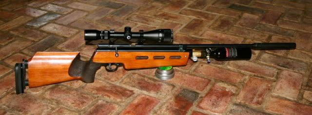

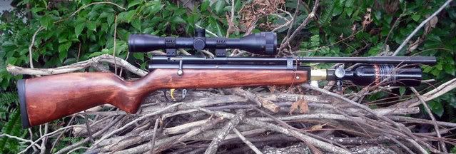

LENGTH:
Kind of up to you, but I generally shorten the tube to where I need to inlet the stock to fit around the gas block. I also use stock screws and epoxy putty bed the block. I like the support. The tank is a pretty long lever, and I'd rather it not stress the gas block mounting when knocked.
Also tend to use the issue 78 barrel band rather than a QB79 barrel band...mostly because inletting a square block is a lot easier than inletting a square block with a band around it.
YEah...that's extra long becasue of the brass on/off. Really don't need it, I just got into the habit. Does come in handy, as it reads output pressure (and these old ones include another busrt disck between the bottle and the tube).
