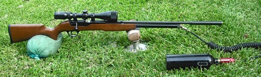

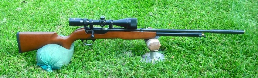

Marc:
IF not moving around, like shooting from a bench or from a lawn chair, just leave the Disco teathered to a tank. It won't be a great power producer, but it can be pretty consistent.
Not a Disco...but likely becasue this rifle was made to operate at 1500psi, the results are likely closer together.
Last summer,I whent ahead and bought the best 12gr. rifle I could find....which was bascly a Hammerli 850 at heart, just kind of adapted and dressed up (AirGun Depot had them as one of their offerings).
Basically, I fell for a pretty face....again....but it actually does shoot freakishly well.
DSCN1228
by
Robert Dean
, on Flickr
