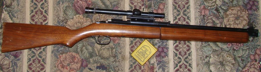

This is the gun that I did the count with, wears a Weaver B4 on a funky, old, Crosman steel mount. Been shooting it this way 3 or 4 years.
