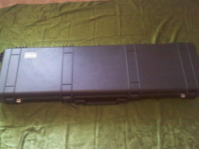

It was with a lot of eagerness that I accepted delivery of an SAG AR2000 Jet from Mike Melick. Before I go into all the details about this gun and how Mikes’s golden touch has worked to improve it, it’s important that I note this gun is a demo. As such, it’s been handled a little rougher, worked over a bit, and some of the work done on it has been geared more towards finding what works with this particular model than extracting the most performance possible. In other words, it’s got dings, some things could probably use more work, and the Jets Mike turns out after this one will probably reap the benefits of the testing he’s done on this mule. Regardless of this, the Mike Melick tuned AR2000 Jet I now have in my possession is nothing less than impressive. And it’s no clone of anyone else’s proven model to boot.
The first thing you’ll notice about the Jet is that it is a big rifle. It measures in at exactly 48 inches long, and the hardwood thumbhole stock is a substantial piece of wood. As will be expected with a rifle this big, it is heavy as well. Weighing in at 10 lbs, it’s no all day carry rifle. With an added scope, expect the AR2000 to weigh in the neighborhood of 11lbs. This one comes in at 10 lbs 10 oz with the basic scope I mounted for testing. However, although this rifle is heavy, it is very well balanced, which has the effect of making the gun seem lighter than it really is when pulled to the shoulder and surprisingly easy to shoot with offhand. Unlike the XS28M, (the most popular of the Chinese magnums), which feels nose heavy making a steady offhand aim a challenge, the Jet feels like it settles right in and will hold wherever you point it. You won’t be able to hold it on target all day, but for the several seconds it takes to make the shot, you’ll be able to line up the crosshairs fairly easily.

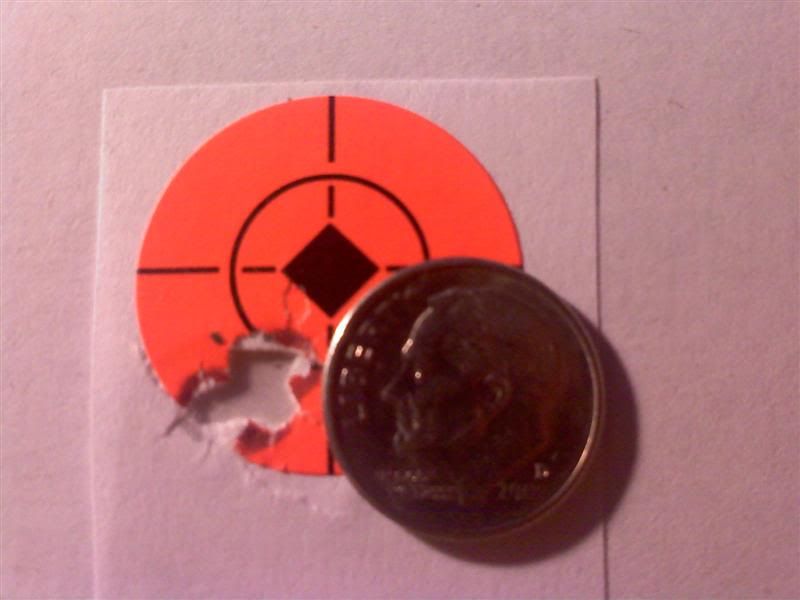

I tried a decent variety of pellets and found that the rifle bore is leaning towards the large side. Pellets with a looser fit produced a noticeably harder shot cycle, lower FPS and FPE numbers, and less than stellar accuracy. Tighter fitting pellets showed the best performance, and out of my available selection the H/N Barracuda 5.53mm 21.30 grain and 18.21 grain H/N Crow Magnums performed best. I still feel I have yet to find the best pellet for this gun, but the Barracudas provided admirable performance as it stands now. Other pellets which worked acceptably were Beeman Kodiaks and the new H/N 19 grain Barracuda Hunter Extreme’s, both of which managed groups just over the size of a dime CTC. This Jet likes a middle weight pellet from about 18 to 21 grains. Lighter pellets were clearly not giving enough resistance, and pellets beyond 21 grains in weight such as a few JSB Monster 25 grain pellets I tried, produced a slightly noticeable piston bounce.

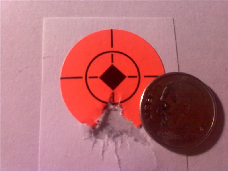

All my accuracy testing was done after a 300 shot breaking in period, during which no stock bolts or scoped mounts loosened, and the gun definitely settled in a bit to a slightly lighter cocking effort and even smoother shot cycle. Shooting from the bench, testing groups with all but the loosest fitting pellets were easily within an inch or better CTC. Loose fitting pellets tended to produce a shotgun pattern. After several tests to determine the most effective hold, the gun began producing dime sized groups consistently using the 21 grain Barracuda pellets. Some 50 yard testing using 2”x2” spinners produced excellent results as well, with 9 out of ten shots using Barracudas putting the spinners in motion.
This gun is very accurate when the shooter does his part, but does require a consistent hold and attention to trigger details when making the shot. I would rate it as being moderately hold sensitive, again probably due to the short stroke and in no small part Mike’s tuning efforts. The gun responds well to a tighter trigger hand hold, but it is still important to allow enough looseness at the forearm for the gun to move. The heavier stock also seems to help calm down the shot cycle and make consistent accuracy easier to achieve. Resting the front of the gun on the flat of the forestock just after the end of the cocking slot produced the best results. During testing with H/N Crow Magnum pellets the Jet produced some encouraging 25 yard 5 shot groups. The following white dots are just a slight bit larger than a dime.

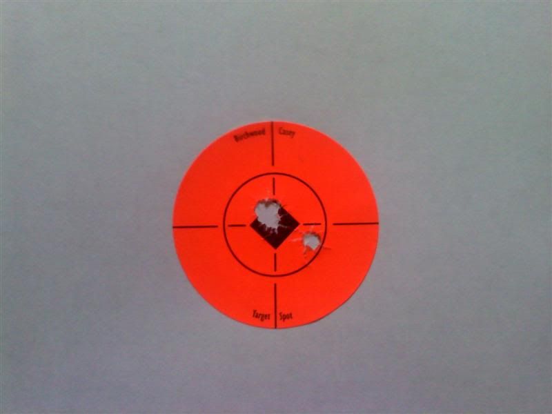

I then moved on to the higher energy Barracuda Match pellets and produced the following 5 shot groups at 25 yards with the rifle bench rested.
As it stands, the Jet acquitted itself well. This is particularly true considering the gun has less than 500 shots through it and was fitted with a throwaway Beeman scope. I am certain once I mount some decent glass and the gun passes the 500 shot mark it will produce even tighter groups as it is showing improved consistency the more it is shot. At this point, it is safe to say the Jet is certainly accurate enough for hunting small game. But what about power? Well, the Jet has it in spades.
