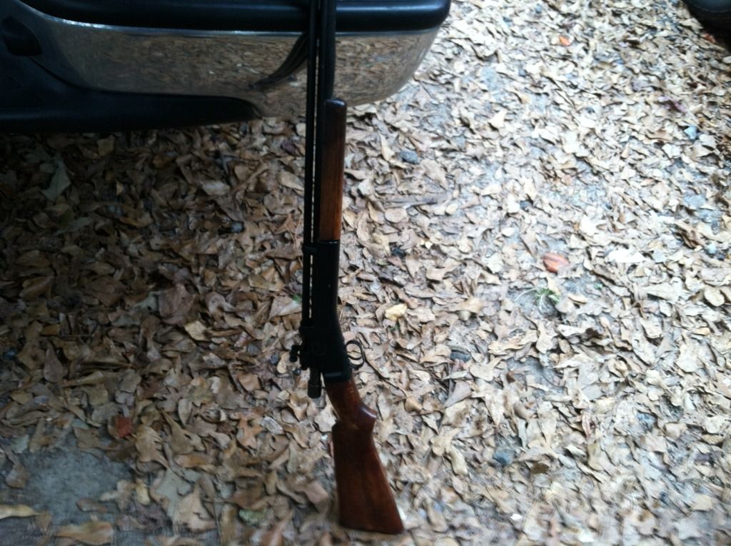

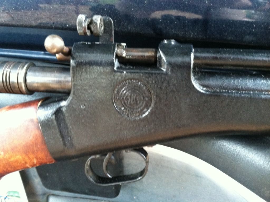

Hi friends, I recently picked up a 1400 at an auction. Unfortunately it did not shoot, I cracked it open and replaced the seals, quad seal was all hard and came out in chunks. Put it back together and it still doesn't shoot. The pump cup isn't perfect but it should be pushing some air into the valve assembly. 10 pumps, trigger pulls and nothing happens what should I try next?
