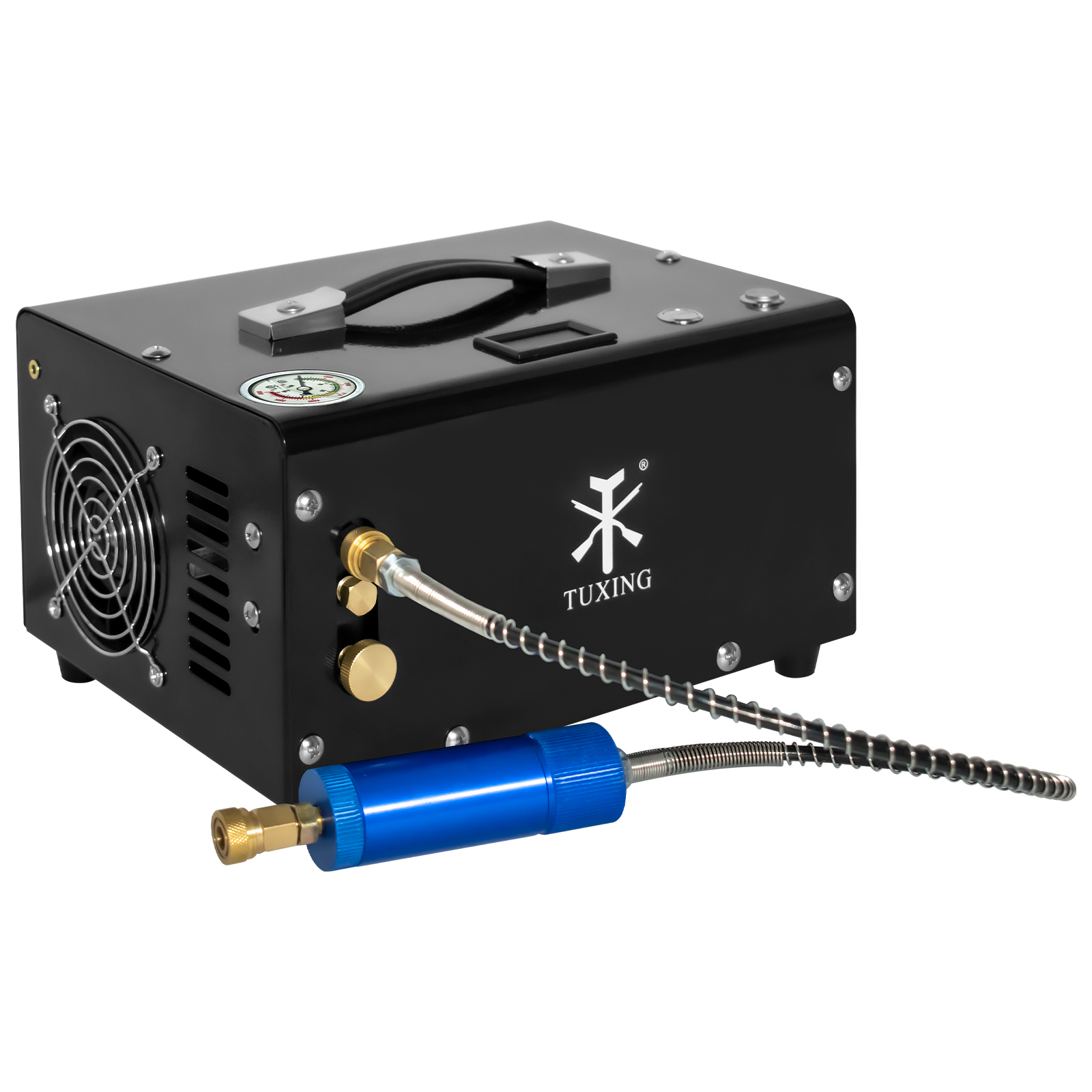

Bummer, one thing I do when done filling for the day is unplug the compressor. I have plugged them in to find they go back on with no pressure . I am awaiting a new filter stack for my Tuxing, the bleed off valve threads stripped out from it vibrating loose when new.
