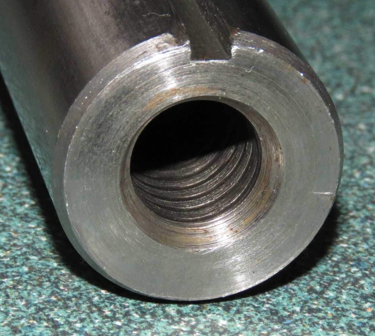

Whatever you want to call is, mine is stripped!.... The Acme threaded screw that drives it by the handwheel is fine, but the female threads in the ram are shot....
If you have one, or know where I can get one, please let me know.... :roll:

OK, so the panic is over, I have ordered two flanged Acme nuts, and I can machine the flange off and bore the quill to suit and then Loctite in the nut.... and I will have a backup, if the first one fails I can heat it up, pull it out, and put in the other one....
However, I think I will purchase another used quill if I can put a deal together on a good one, just in case....
Thanks to all who helped.... The response was overwhelming, and much appreciated....

I repaired my lathe today.... Bored out the quill and inserted a new Acme threaded brass bushing with Loctite 638.... It turns out that the difficulty I had drilling those Metric bolts was partly the threads in the process of stripping.... The repaired lathe drilled them no problem, with HSS drill bits....
