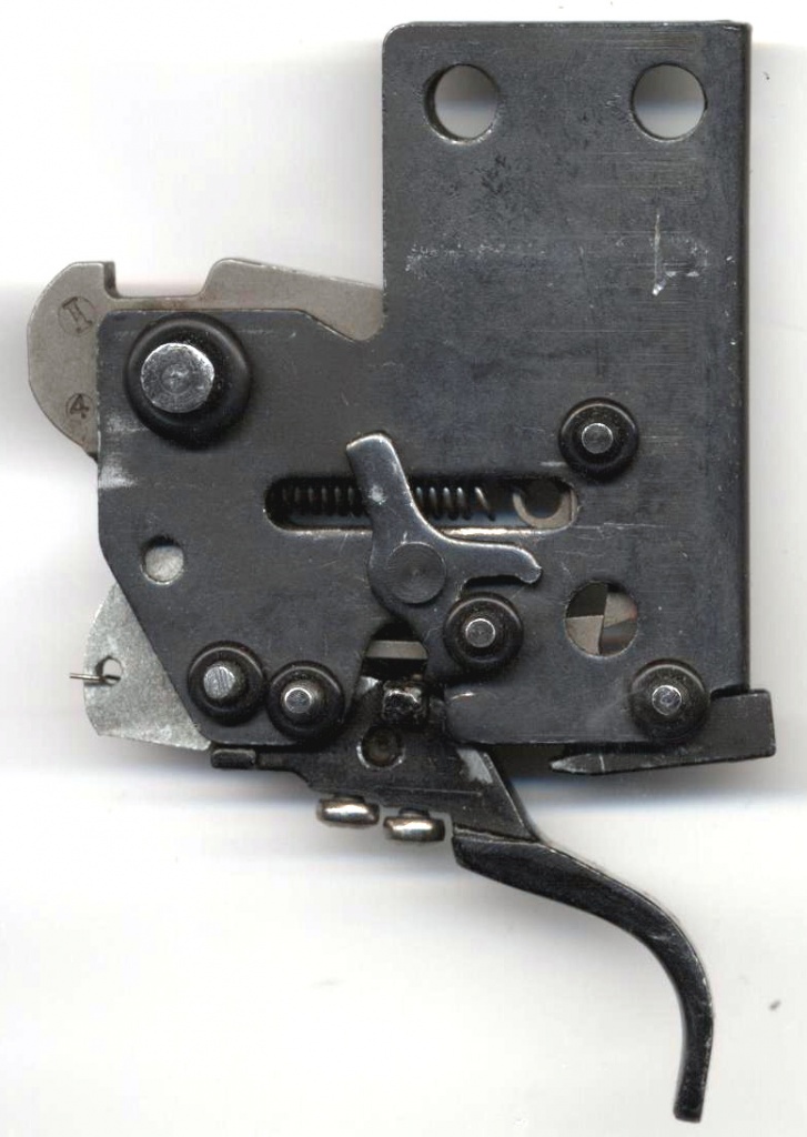

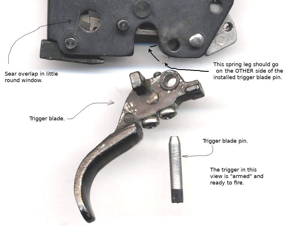

There are a few tricks that make tear-down and re-assembly easier on Hatsans. The process takes less time the more you work on them.fyi... I like to use snug fitting o-rings on the Quattro pins to keep them from falling out.
Grooved pins with clips is most secure but is beyond folks like me who don't have a metal lathe.The o-rings pictured are on "oem" pins. I don't think you can replace these pins with longer pins and still install into the stock. When the trigger group is installed in the stock the stock itself keeps the factory trigger pins centered in-place.CAUTION: I'm not certain but i don't think there is enough space for my o-rings to come off the pins once the trigger group is installed in the stock. If I'm wrong a loose o-ring floating around could cause a trigger malfunction. That has not happened to me (yet).
Mikey,Thanks for your reply. I was thinking about why I could not get the second cross pin through the trigger block. I suspect the metal in the area of that pin must have been slightly deformed by my manipulation. This was the middle of the three cross pins. The most forward of the cross pins went in very easily, and honestly, it's hard to keep that front one in place-it just slides out unless I've got tape over it.When I replace the o rings in the dead Vortex spring, is it reasonable not to disassemble the back part of the spring, where the filling port is? Not likely the o rings back there are compromised, since there is really any movement happening there, I figure. Interested in your take.Dennis
