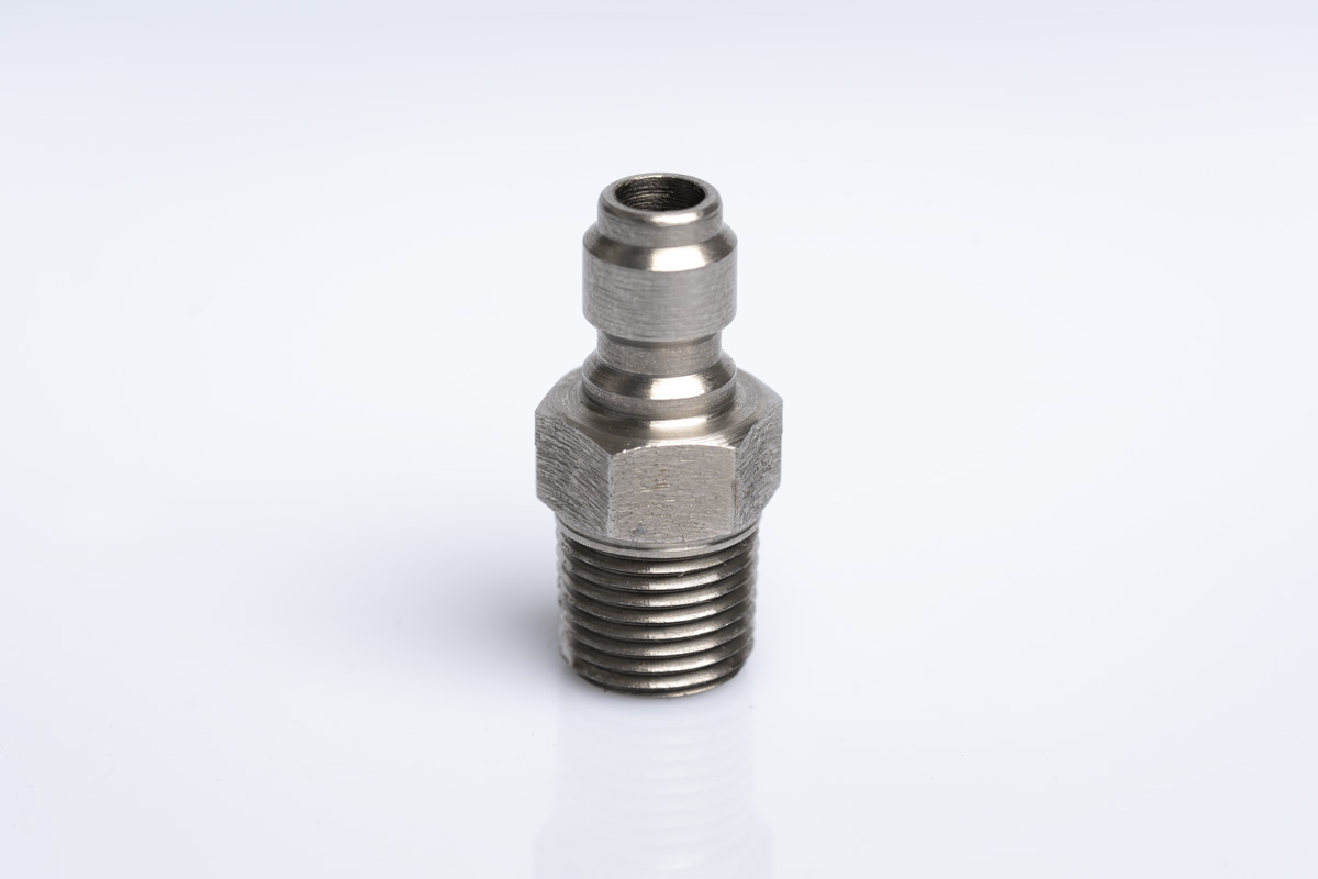

The 112 is already Bulk fill. All you need is a 1/8" NPT Foster male quick disconnect.. available from any Air Gun / Paint Ball supplier. It will thread into the original end cap that already has the "check valve".
Terry, I don't think that being tethered is the point. I assume the OP is wanting to "Bulk Fill" with modern equipment instead of the original tank set-up.
