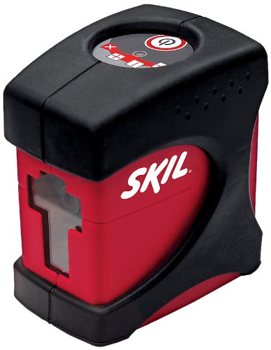

This is some really great info, I will be re-adjusting my scopes tomorrow for sure. I have a laser lever that will be perfect for the job! I often get times when my POI is on at close range and off at longer ranges, now I know how to correct the error using the proper adjustments and tools.As for setting Distances as some have mentioned I do understand it doesn't matter as long as it is 10 +/- or 30 +/- a couple yards, I site in at 40 yards zero on my guns depending on the FPS or the weight pellet I am using. Anyway what I am really trying to say is I never measure my distance to the target from the muzzle, what good would that do (nothing) in my opinion I am not going to step in front of my muzzle every time I check a distance. After all, I do use a laser range finder at my eye not from the end of the muzzle. Besides 2 thirds of a yard isn't going to make a differnce anyway, unless you shooting past 2 or 300 yards at a low velocity!My Skil Laser Level... I may have to wait until a cloudy day or just before sunset due to it my not show up in bright daylight. Works great indoors. I have woods where I shoot so maybe it will work ok in daylight!Thanks for the info Scott and everyone else as well William

This is some really great info, I will be re-adjusting my scopes tomorrow for sure. I have a laser lever that will be perfect for the job! I often get times when my POI is on at close range and off at longer ranges, now I know how to correct the error using the proper adjustments and tools.As for setting Distances as some have mentioned I do understand it doesn't matter as long as it is 10 +/- or 30 +/- a couple yards, I site in at 40 yards zero on my guns depending on the FPS or the weight pellet I am using. Anyway what I am really trying to say is I never measure my distance to the target from the muzzle, what good would that do (nothing) in my opinion I am not going to step in front of my muzzle every time I check a distance. After all, I do use a laser range finder at my eye not from the end of the muzzle. Besides 2 thirds of a yard isn't going to make a differnce anyway, unless you shooting past 2 or 300 yards at a low velocity!Thanks for the info Scott and everyone else as well William
