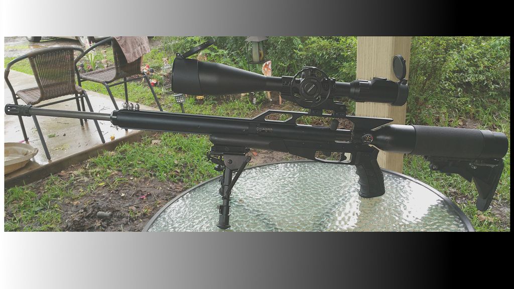

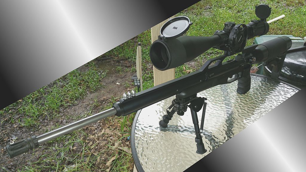

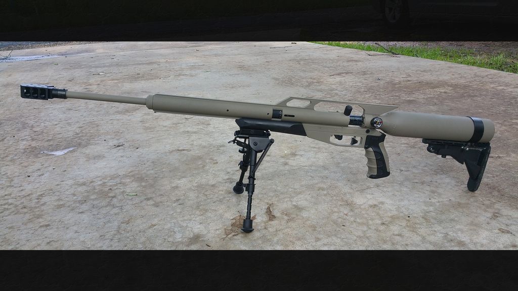

Hey everyone, I'm new to the big bore side but not the forums. Just got my Eldy's Big Bore .357 kit installed, and with factory internals on a mild ported factory tophat, she pushed 144 fpe with the 115gr air venturi round nose bullets at 2600 psi. I now have a 25 gram striker weight(diy) (Thanks to Eldy for the collar shaft idea!), and a Talon Tunes Quick Change Tophat, but I havent tested since the mods. Any idea what to expect?
