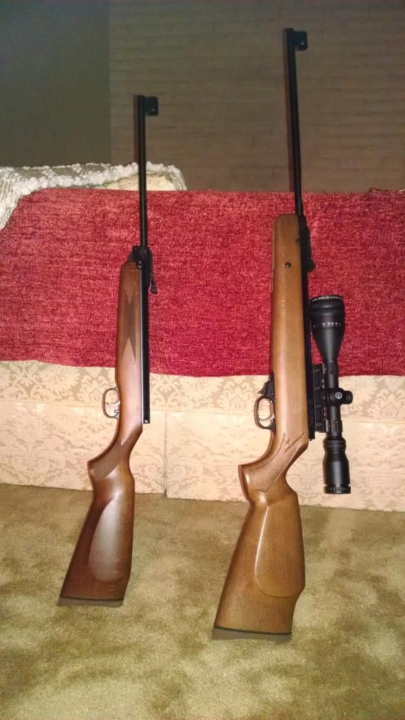

I'll try to edit in at least one pic.......I know everyone likes pics!
