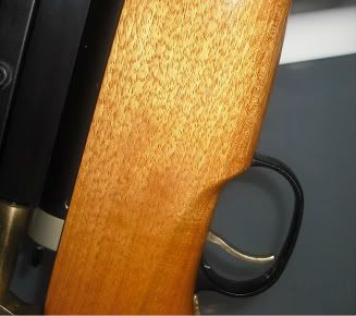

6. Why is the trigger so curled and in the middle of the trigger guard? Should be a bit less curled and more towards the rear of the guard-space for a better visual (and a less long reach to the trigger).
It’s a minor thing, but did have to get that trigger a bit straighter and working more towards the rear of the trigger than the middle.

I gently straightened my triggers in a vise, with brass jaws. They straightened very easy without any heat.
