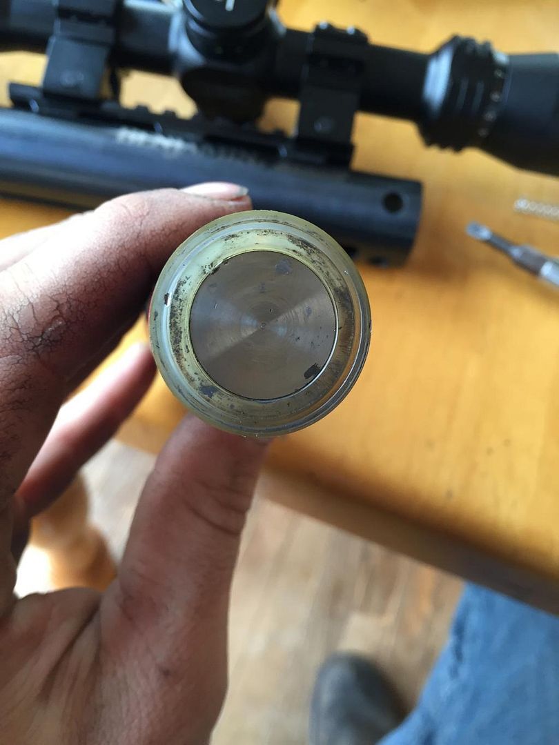

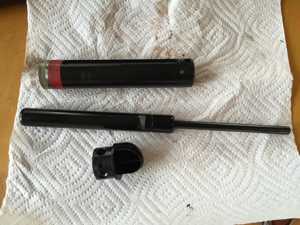

Brian, thanks for the pictures. I just took my NP2 apart. Other than being gritty, it showed no sign of wear except on one of the nylon balls on the piston is flattened out. No sign of metal to metal wear. The piston seal shows no sign of wear. I took pictures on my iPhone and need to figure out how to get them here. All you used was Moly grease to coat the cylinder? Can synthetic motor oil be used if I don't have any Moly?Going to call Crosman, again, to see if they will ship me a few of them. Now I have to figure out how to remove and replace them

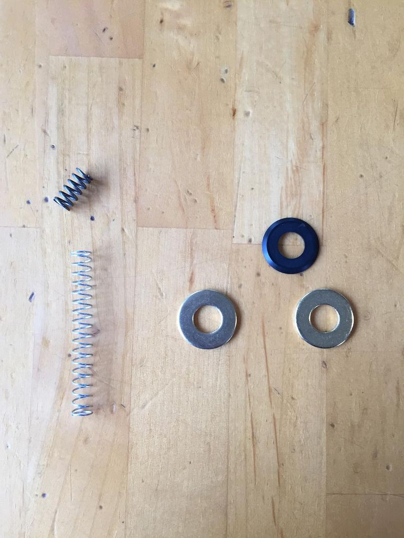

One thing to add about the pivot washers is crank that screw down until the barrel can just barely be held in any position after its cocked. That has seemed to be the perfect tightness (I know technical term lol) it minimizes almost all the side to side play the barrel can have at the pivot point
