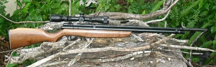

October 13, 2014, 07:40:53 PM »

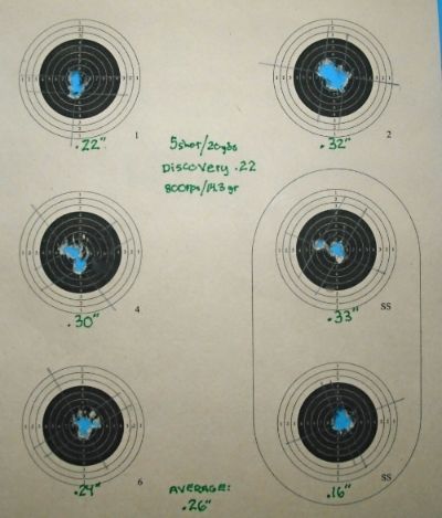

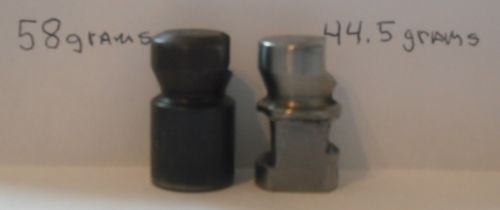

Actually, I’ve very happy with my plain looking Discovery, but realize I’ve been pharting around with it for several years and have had time to get the little kinks out of the system.
Looks pretty stock.
1. 2 screw mod (tried the 3 screw mod and removed the 3rd screw)
2. Lighter weight striker (this one done by grinder/file rather than lathe):
3. 2nd barrel band inletted into the stock at the rear (Challenger PCP idea).
4. TKO
5. Simple power adjuster (spring guide and a headless screw in the supplied threaded hole in the end cap)
6. Slightly reduced transfer port
7. polished chamber throat/barrel transfer port (removing burrs)
8. 6-screw front barrel band (bottom 3 tight to the air tube, top 3 just barely slack to the barrel).
Shot count:
Typical accuracy:
Shoots some pellets better, some worse, but this is about the average.

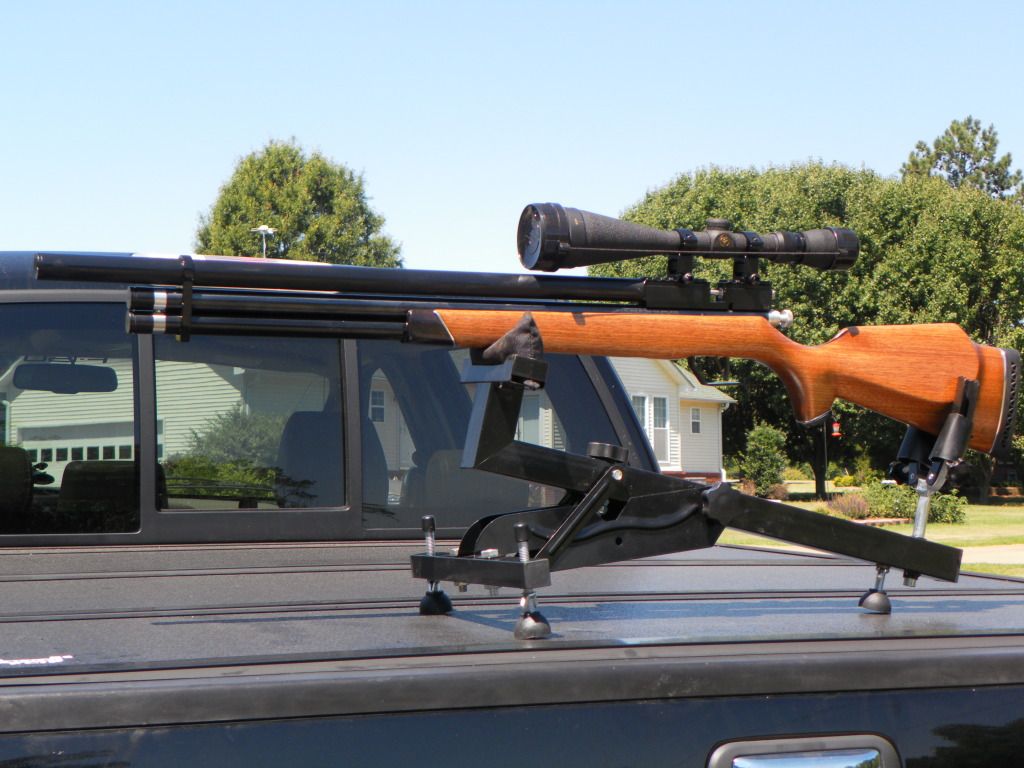

Oh my, where to start,
1. BNM Multi-shot Breech w/shroud
2. 3000 PSI Mod - High Tinsel Screws holding valve (10x32)
3. Power adjuster
4. Spring Guide
5. Regulated at 1800 PSI ) thanks to milo74 for the custom regulator.
6. Blaster Stalk
7. Reamed out Pressure Gauge Block for better/more air flow
8. opened Valve port and barrel port {more air flow)
9. 3 Screw Trigger Mod.
10. New sling swivel studs, on all my guns.
11. 3000 PSI Gauge.
12. 2nd Barrel Band
13. Almost forgot: Disco Double Tube Kit
I have over $1000 in this Disco with the 6x24x56mm Scope and rings. Please don't tell my Wife....
Full power she shoots 25 to 30 shots at an average of 920 FPS with 15.9 Grain JSBs, 3/8 to 1/2 inch groups at 50 yards consistently.
Everything except the regulator came from
Norm at Discos R US
http://discosrus.net/
Regulator and Plenum
Regulator approx install area
William
Last Edit: October 13, 2014, 10:00:06 PM by jake37

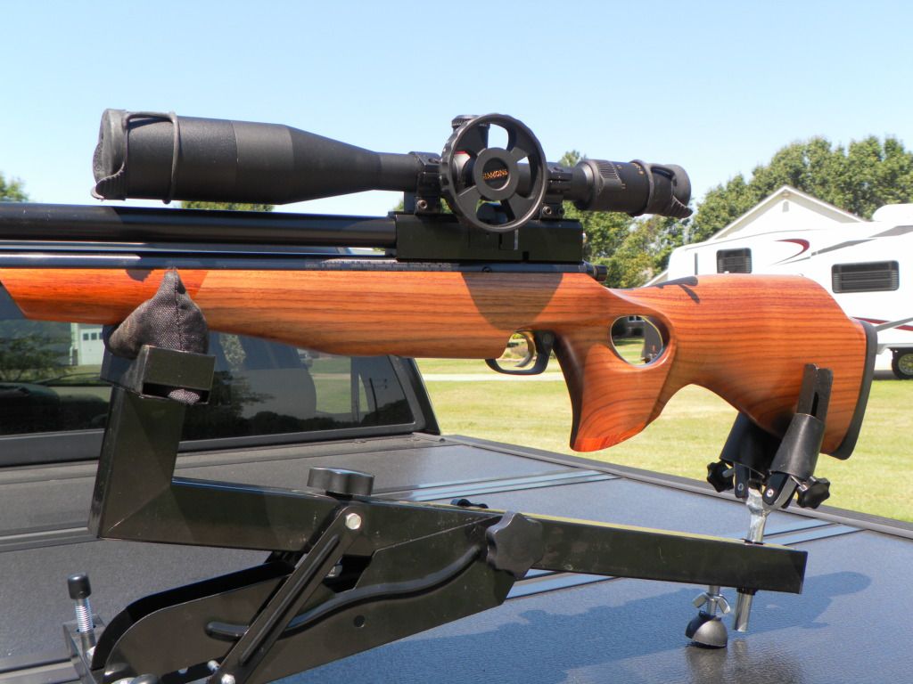

Re: Show off your Disco
October 13, 2014, 09:34:24 PM »
Argh, jake37 beat me to the disco double photo.
Max flow valve, and enlarged transfer port,
rear velocity adjuster,
Custom trigger,
mellon bolt and probe,
disco double tube, and stock from norm at discos r us,
TKO,
Tasco 6-24 mildot.
~900FPS for over 40 shots. 2000 psi fill
Functional accuracy: less than 1 inch at 25 yards for over 40 shots with 14.3 gr cphp from the tins.
JSB is better.
Last Edit: October 13, 2014, 09:39:55 PM by 45Bravo

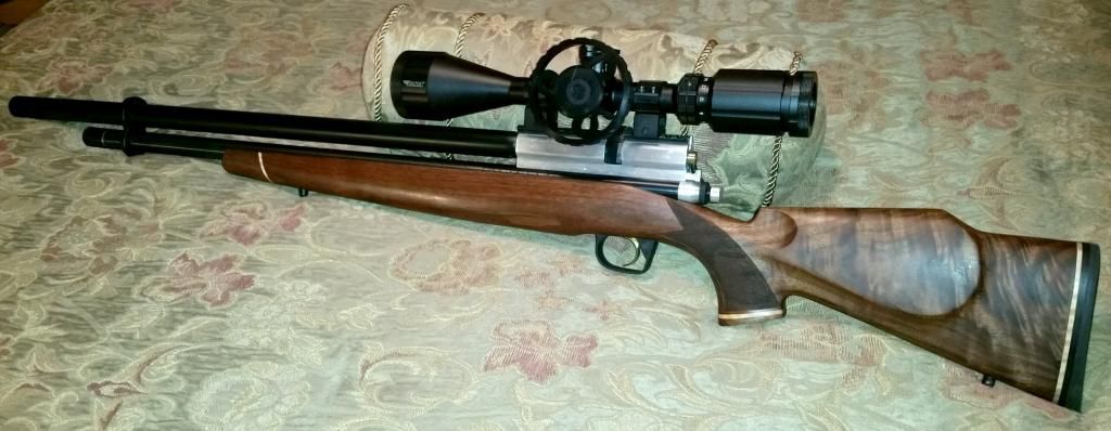

Here's mine:
British Columbia, Canada

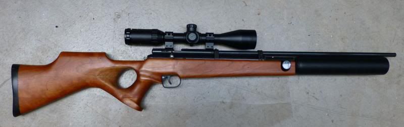

October 14, 2014, 01:16:00 PM »
i built mine last year
i made my .22 Disco into a .25
Michael Chavka stock
BNM .25 cal breech and power adjustment
.25 cal Marauder barrel and shroud
Bryan & Associates Boss MaxFlow valve
Marauder trigger
Challenger trigger guard
No. Calif amongst the Redwoods

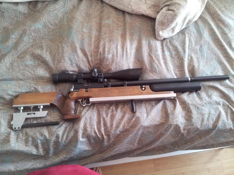

October 15, 2014, 06:07:26 PM »
Here is my latest Build.
Benjamin Discovery .22 PCP Full BNM Setup. 10X40X60 ZOS Scope. Boyd's SS Stock. JDS Airman Bottle, Adapter & Regulator, 1600 psi filled to 3000 psi 60 + shots 1holer at 35-50 yds. Best with JSB Diabolo Exact Jumbo .22 Cal , 16.83 gr.

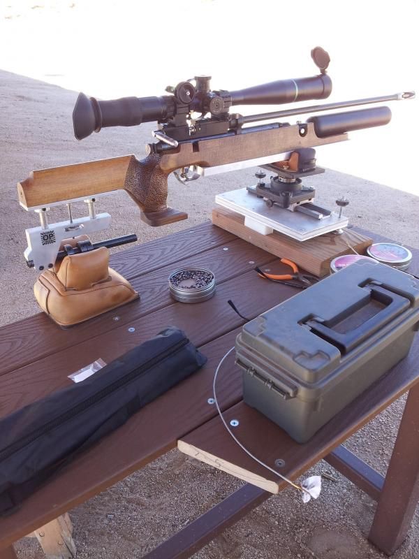

October 15, 2014, 09:22:58 PM »
It's hardly a disco anymore. But have the tube, hammer and valve. And the BNM breech.
The rest is all custom stuff. On a good day it does 1/32" groups at 37yds
Phoenix
WAR Flex .22, Reg, CF sleeved, Apache Stock.
40 fpe Benjamin Discovery.
