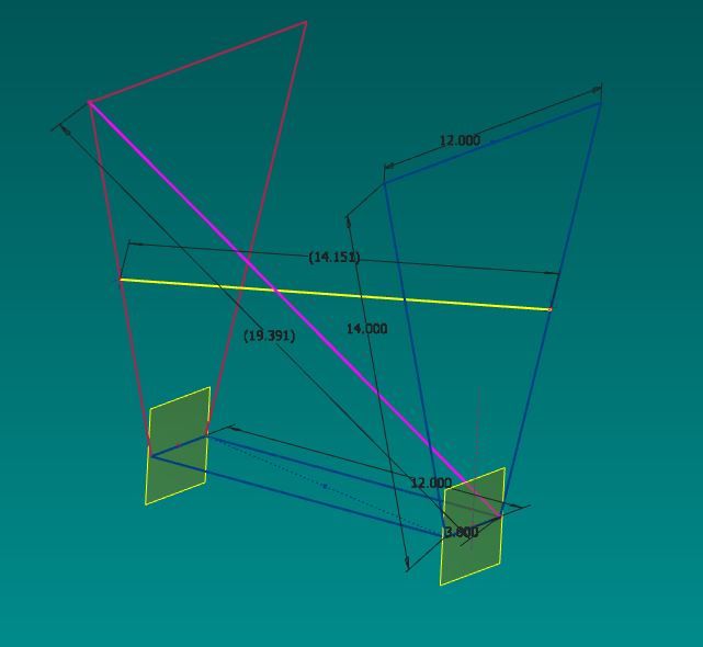

It's not so much a matter of right, left, or middle.....it's presenting the pellet at an angle over the plane of the sensors. The thing works by using the time it takes to cross over both sensors, then formulating the velocity by a calculation. The amount of time between the sensors is very, very small.....so any increase in the distance can result in errors of calculation.If you measured the distance between the 2 sensors straight down the middle......then measured the diagonal distance.....you would clearly find the diagonal to be longer. Shooting on a diagonal (whether it is in the horizontal plane or in the vertical plane....or both )at all will produce slower velocities compared to exactly straight and level over the sensors.This is an experiment that I have been able to repeat very consistently. Shooting through the chrony at a long distance away makes it tough to get the alignment perfect. This is the reason that so many people come up with drastically different BC's for the same pellets when testing this way. You have to be extremely picky about the setup to end up with any valid information....and even then I'm not so sure.Hope that helped,Mike
I THINK grumpy meant to say you are not supposed to change..My thing is how many of the air gun writers (videographers) do you see just point the rifle through the screens without choosing an exact point to aim at? (Rick Ustler for one) and he uses a CE Pro chrono.If moving the projectile path left to right across the screens can cause ANY variation in readings, then 98 percent of your readings should be suspect...
