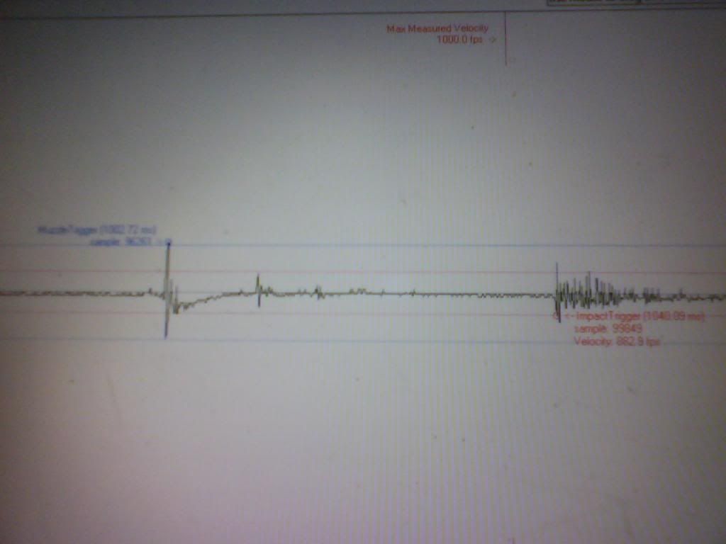

Bart, I got softchrono working & can see the shot wave form. I'm not sure what I should see or look for. I recorded a shot with audacity & got a similar wave for it. After shooting today, the sound is not so much a crack. More like a low pop. Seems like the sound reflecting of my trap behind the crony has a different sound than shooting to my 10 yd target I still need to get another spring for the valve. When I get it & change it, I'll try the adjustable piston that I made. Something changed since now the pump arm wants to drop open at 5+ pumps.

Hammer bounce will show up as another spike (or two or three) right after the main shot. As for the pump arm falling, have you pinned the valve yet, and what are you using for a pump pivot pin? This is what hammer bounce looks like. You can see the two impulses after the shot, and before the impact.

February 07, 2014, 03:58:24 AM »
Bart,
Thanks for the picture. I tried to get a similar waveform but so far no success. I got the mic @ 5' & a can @ 10'. I need to get a longer cable so I can move the mic out to 10' or 15' & the can out to 20' or 30'.
As for the pump arm, I'm using the stock roll pin. I have not pinned the valve yet. A post that K.O. directed me to gave me the idea of using the tp to lock the valve to the pump tube. The od of the last part of the valve port is slightly bigger than 1/4". The hole in the pump tube is about the same. I'm thinking of making a brass insert that will lock the two together.that should keep the valve secure.

My mic is at 16.5' and a 14 ga steel plate is at 33'. Gives a nice clanngggg,

today i tried to get a shot waveform from softchrono & still no success. could be where i'm shooting has too much echo since if i fire with no pellet softchrono shows 714fps or 1040fps depending on what i set the max fps to be.
