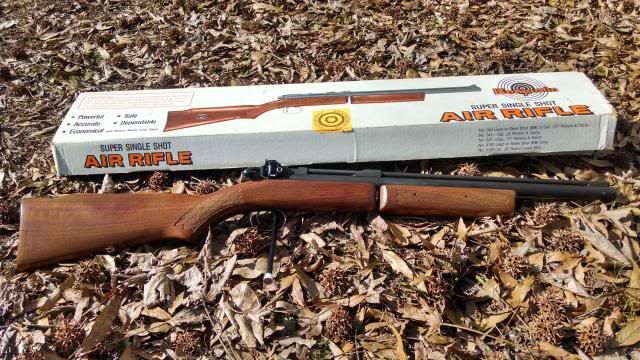

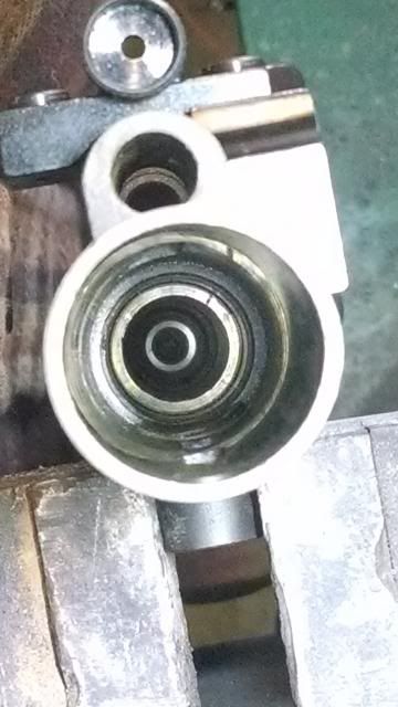

So I bought a near mint 1981 Benjamin 342 in the box a few weeks ago. It pumped and fired fine but had a small leak. So after a couple days I decided to reseal it. I got some new parts and started to disassemble the gun. When i was trying to dig out the upper lead seal I slipped up and dropped a punch and it fell into the valve and took a chunk out of the inlet valve seat. DOH!!
That surface must be flat for the flat side of the inlet seal to seal against under pressure. So essentially the gun was ruined.

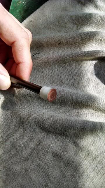

So I put it away for a few days and got a plan together. I had to make a tool that would resurface that little ridge till it was flat again, but it also had to be kept level and true. I dug up a scrap of delrin and a carbon fiber arrow shaft out of my busted arrow bin, and turned down the little delrin scrap to fit snugly inside the valve body. I then pressed the delrin into the arrow shaft so I had a handle. I punched out a circle of 320 grit emory cloth ans glued it to the face of my delrin plug. Here's the tool:

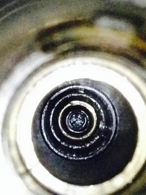

After a few minutes of twisting the tool back and forth, I pulled it out and peeped inside with a flashlight and was delighted to see this:
Success!!

I have to say, I'm impressed! The gun holds air and functions great, shoots just as hard on 8 pumps as it did stock, but now i have the option to crank it up when I need more grunt. My friend has a stock original '74 Blue Streak and you can hear the hammer bounce with each shot. It shoots 650fps but it's just not "crisp' sounding. This little 342 just lets out a sharp "crack" and even has just a touch of recoil hahaha
I finished the gun off by removing the stock rear sight, and drilling and tapping the breech to fit a Williams peep. Accuracy testing will begin here soon. I have plans to cut off the factory front blade, and replace it with a Weihrauch front globe with the inserts. This will not only make the sighting system a little more precise, but it will also raise the front sight so that the rear peep can use it's full adjustment range and be able to go low enough to zero the gun at close range. That seems to be a common issue when adding a peep to the 342. Hopefully it will work out
