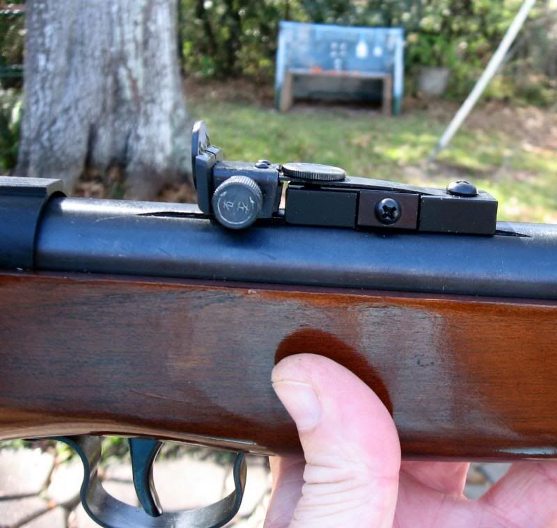

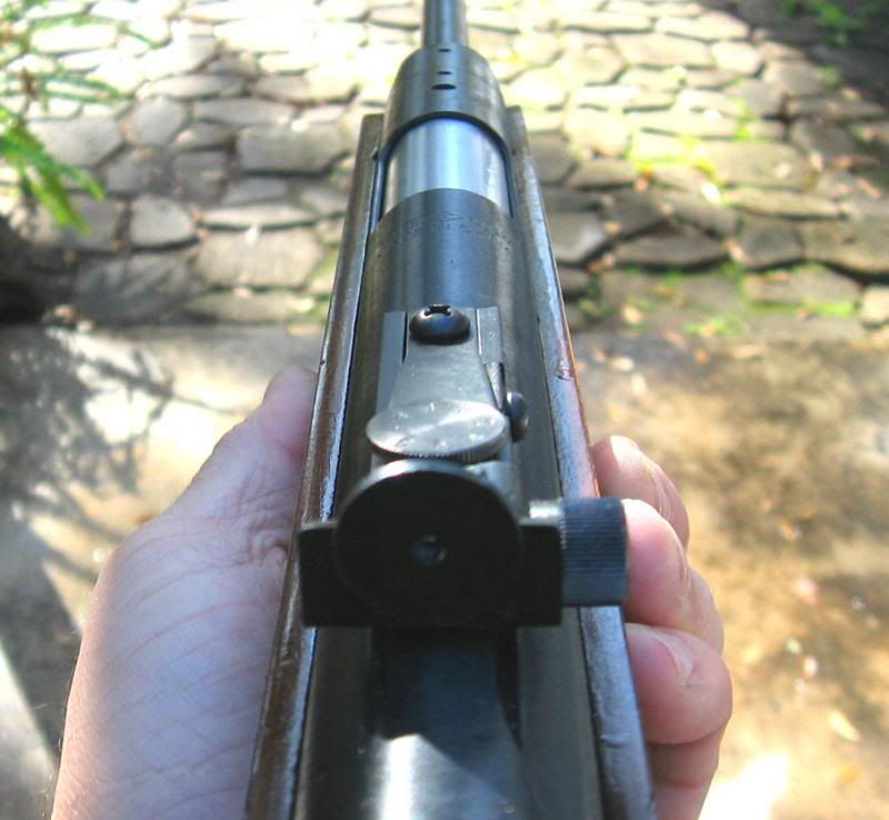

Since I tuned my B3-3 .22 I've been wanting to mount a rear peep sight on it. I know that PA has a Williams sight that should work great but I like to use what I have. I have a few extra 11mm mount rear sights that come with AR2078,AR2078B and Techforce 79 rifles,they are windage and elevation adjustable. This rear sight works great with very minor modification.The screw that holds the elevator/spring needs to be shortened and the body of the rear assembly had to be ground on the bottom to get it low enough. I cut a poly blinder and super glued it to the rear open sight to create a peep. This is working great and is so much more fun than using a scope.
