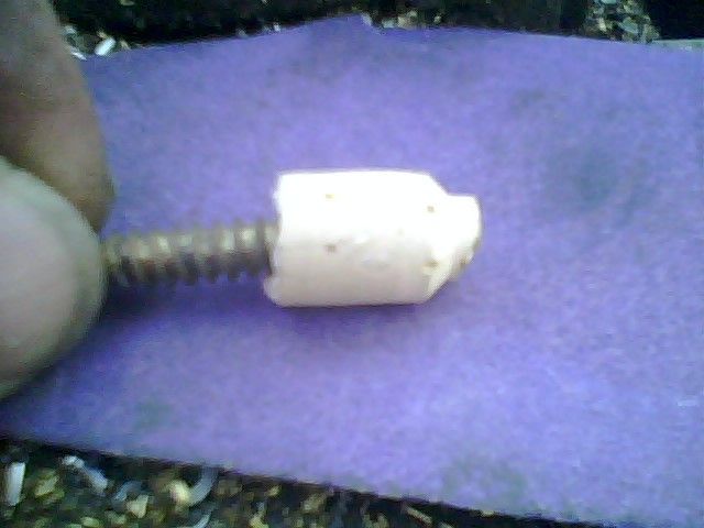

The first step was to mold a plug of the inside of the factory cap. Greased up the inside and filled with epoxy, when set pulled it out with a screw.
Next chucked up a piece of good stuff, and copied the plug with the addition of a 1/16 od pilot.

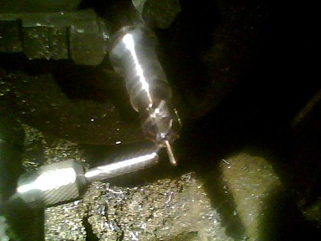

Tomorrow the flutes will get ground in with a Dremel mounted in the toolpost.

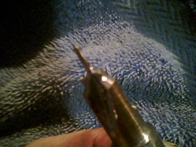

I need a better camera
Made the first pass on the flutes with a carbide burr.
The next passes will be with a diamond wheel, then it will get quenched and tempered, dressed with a diamond stone and used.

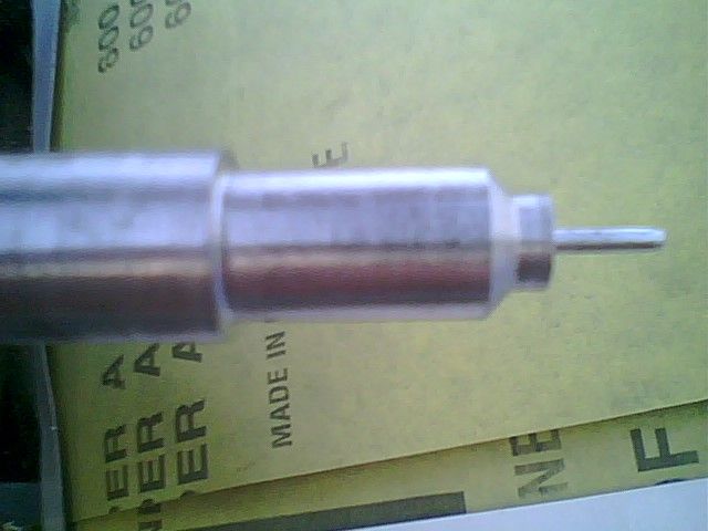

Fluting finished.
Tomorrow it gets quenched and tempered, then final honing.

The tool is done and works a treat. Got the test cap done, will install it tonight, and chrony tomorrow.
Mav; Quench and temper is not that hard. This tool was made from an old strut rod. What the material actually is
all I know is it is a water hardening grade not an oil hardening grade.
To quench and temper an unknown steel. Heat to a bright orange and quench in oil. Check hardness with a file, if the file cuts the metal, reheat and quench in water, retest. If the file still cuts, the steel is non hardenable. If the file slides the steel is a water hardening grade. To temper is to draw the hardness a small amount to reduce brittleness. For a cutting tool 400-500*F usually works OK.

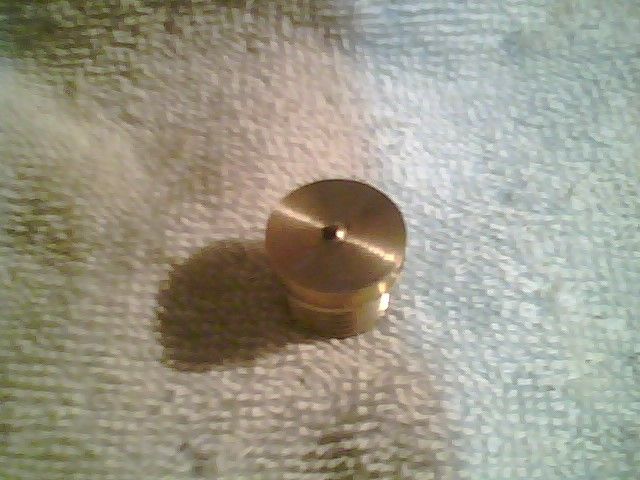

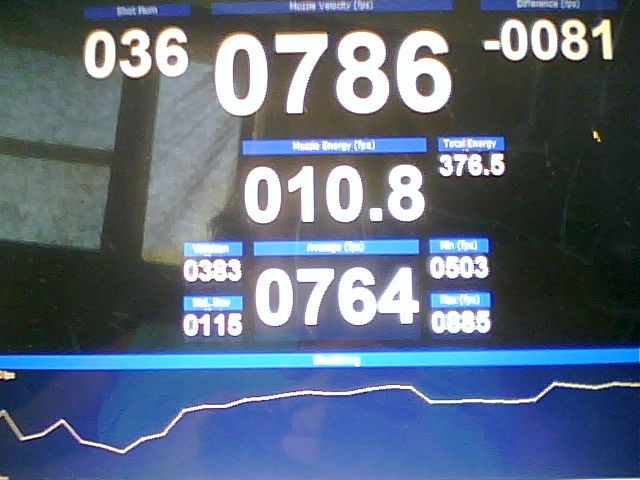

It Works
Got it installed and chronied. My 766
is
modded, so your results may vary.
Here's mine at 10 pumps with 7.9 CPHP's.
This is with a factory short check poppet, a very light valve spring, stock striker spring, a Delrin poppet, and an O-ring sealed breech.
It hits ~870 fps with 16 pumps now instead of 855 with 18 pumps.

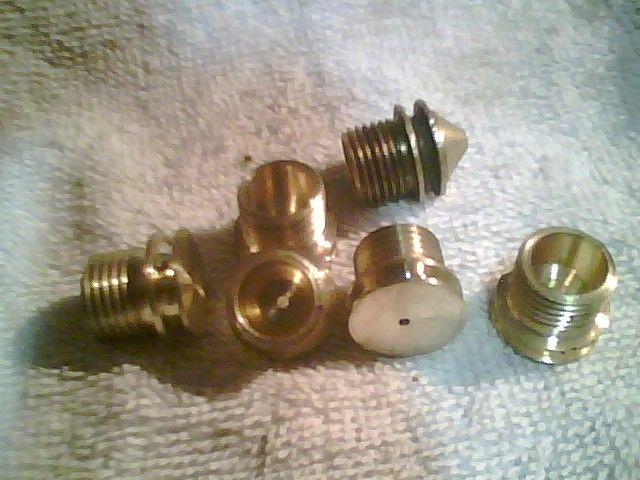

Finished six brass ones today.
Broke my 1/16 drill bit
need to buy a new one to continue.
Two have visibly off center inlets caused by a very flexible drill bit, being used to drill to deep.
Those I may keep here. Once I have a new bit I will make a run of aluminum ones.

Something has happened in the 2200 valve. As it held pressure overnight last night. I shot it about seven and at one am it was still very good. I pumped two additional times but when I shot the pellet went right thru a good sized rat and heavily dented the feed troth. It's about 16g steel. So I may hold off a little longer and see how it works. I like it better than the 1377 as it's 22 and kills better in body shots. Plus it's easier to pump for momma.
. Momma like to shoot too!! She is usually right there holding the light when I do the permimter check.
