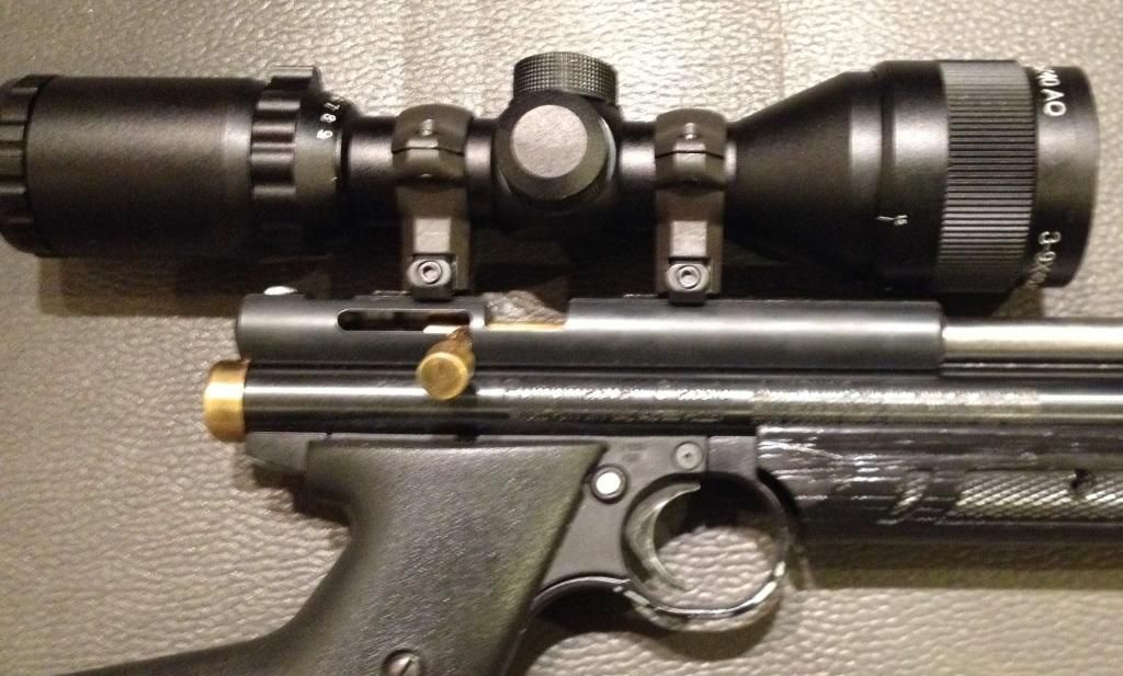

There are tons of mod parts out there for the 13xx platform. Mr. Chavka makes some great parts as does bluefork. Here is mine. It seems to change all the time.
