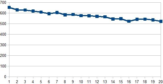

Here is a 20 shot string. The first shot was 8 inches high as I had just replaced the valve with a new design. I adjusted for this on the remainder of the shots.

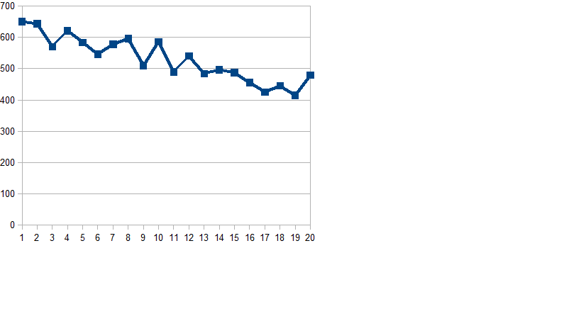

This is the shot string over the chrono. Pressures, 1000psi to 580psi. Compare this to an initial string from January.
Quite an improvement, IMHO.
The following changes were made since January:
The valve head was decreased from .500 to .375. The valve face was flattened from a 90 degree to 110 degrees. The valve orifice was retained at .302 and taper of 120 degrees. I think this reduced 'stiction' of the valve and decreased shrouding. It did improve consistency and increased average velocity. Didn't change the maximum power though.

On average, it looks like you are losing about 1% velocity per shot, and about 2% pressure per shot, in pretty much a linear fashion.... For a gun where the valve / hammer strike doesn't self-regulate that's probably about as good as you're going to get.... WELL DONE !!!
