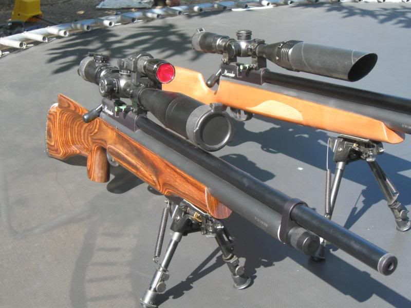

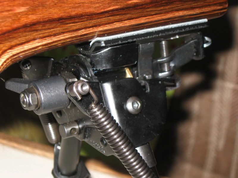

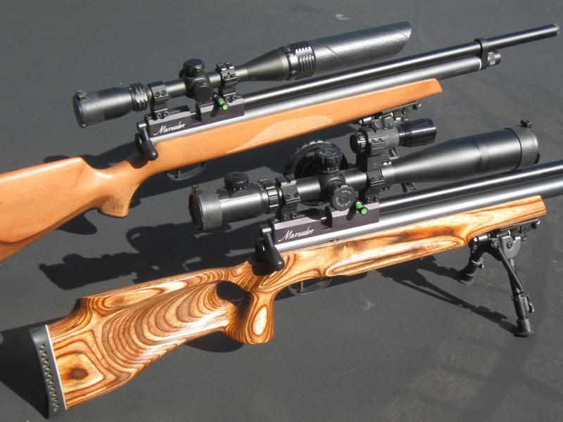

June 09, 2013, 02:43:38 PM »
I had no hesitation whatsoever with putting one on my Boyds Blaster.
I used the stud mount for a sling swivel, but a weaver plate can also be used.
I HIGHLY recommend getting the "Pivioting" type, ("tilting", to some of you),
Both of mine are the Blackhawk brand and work just fine.
The one available at WallyWorld is usually the 9" to 13" model# 71BPO3K
but if you prefer, you can go on ebay and find the 6" to 9" model# 71BPO5K for about the same price.
I prefer the shorter one for bench shooting and use a sandbag at the rear.
I Do Not recommend any with "Traverse" (swings left to right).
The Pivot w/traverse has waaaay to much slop in them for my liking. (even when tightened down to maximum tension).
Both of mine have the telescoping legs, which are ok and work fine... but I do want to get a "notched leg" type next.
I think a notched leg type could be a bit easier to fine adjust it to your preferred shooting height.
example-
http://www.ebay.com/itm/Caldwell-XLA-6-9-Inch-Pivot-Bipod-247-142-/181152959686?pt=LH_DefaultDomain_0&hash=item2a2d8eccc6
Here's both mine and my daughters, with Blaster, and OEM stocks.
Hers wearing the 9"- 13", mine wearing the 6"- 9"
hope this helps

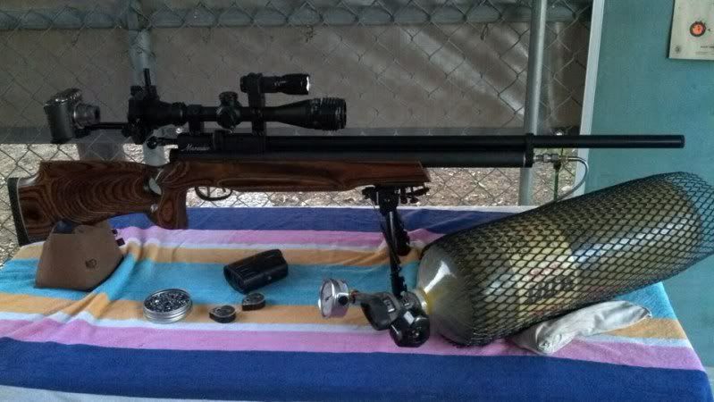

My Blaster with bi-pod......
