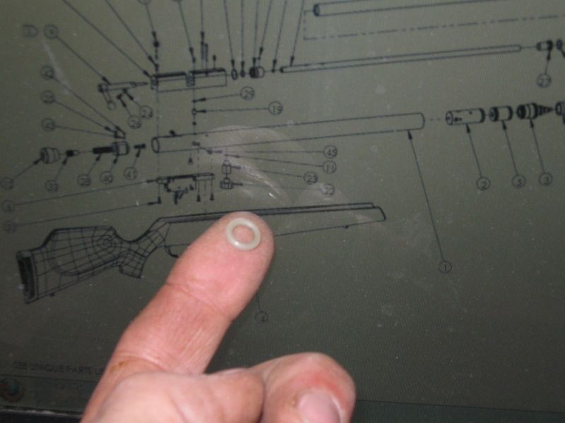

ok guys,
I just pulled a major brain-fart.
I just fired my Mrod without closing the bolt.
nowI found a O-ring wedged into my clip.
I pulled it out of the clip, and it does not look damaged.
can it be re-installed ?
and where does it go
I looked on the exploded view, but I'm not seeing it.
I'm assuming it came from the rear side of the breech ?
I have never yet taken the breech off of the rifle.
Does it need to come apart to install this O-ring ?
Also, did I screw anything else up ? is there anything else I need to check now, after doing this stupid maneuver ?
Thanks for any advise and/or pics.

Re: Marauder breech o-ring ?
December 16, 2012, 07:46:59 PM »
Look at part #10. that Oring fits in the barrel. you can try to get it in without taking it apart, its easier with the barrel off though. there is a groove that the Oring set in and you have to push it back into that groove.
lube the Oring with some silicone grease and push from the breech side, if you have a dowel that will fit into your barrel. using the dowel will assist you in pushing it too far into the barrel.
like I said , its easier with the barrel off.
I dont think you messed up the mag, but make sure there are no nicks on the Oring that might cause a leak at the bolt.

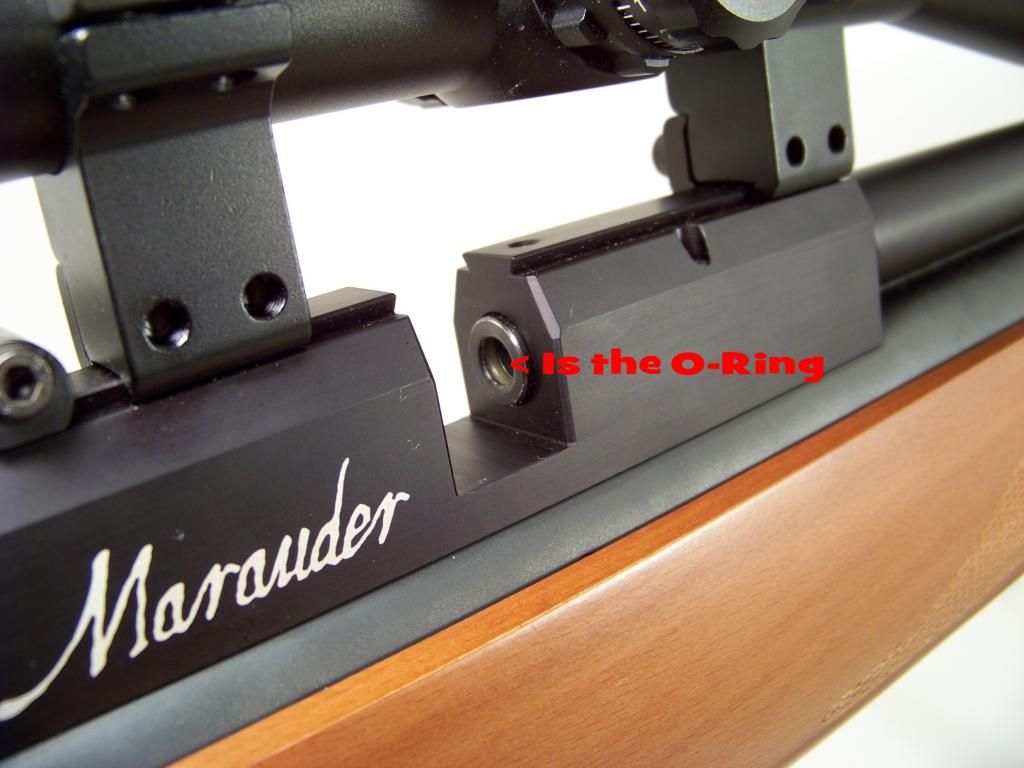

golddredger
December 16, 2012, 08:09:46 PM »
The air pressure went backwards into the breach instead of down the barrel popping the o-ring out with it and pushing it into your clip. No biggy. Nothing hurt. Now just push it back into place. Here is a clear picture of where it goes. Have fun and do not worry we all have fired with the bolt open. it is easy to do.
