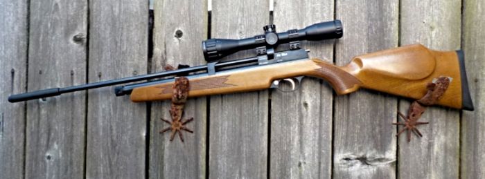

As show, with the loaded mag, full sized 4X32mm scope, and 3 full 12gr. in the tube, runs right at 6 pound even.
Set the rifle back to close to factory tune specs. Not uite, as the striker spring guid had been shortened a bit, but the rest of it wwas as close to "out-the-box" as possible.

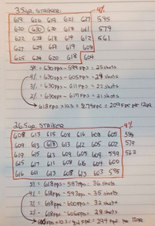

Shot one 12gr. over a chronograaph at near factory specs.
Took it apart and shanged just the striker weight. Striker sping tension, spring guid, transfer port, etc., were the same, only the weight of the striker was changed.
Turnes out the issue striker comes in at 35 grams. I wanted to go for a 20% reduction in weight (to 28 grams) but I slightly over-shot that and eneded up at 27.5grams. NONE of the tube-bearing surfaces where changed, the sear is the same, as is the lenght of the striker.
Comparison shot string:
I'm not "there" yet. HAve about 1/2 foot pounds X 35 shots to trade for another 5 shots...which would be easily "do-able" to reach 40 8-ish foot pound shots per 12gr.
SOooo..the end result of about a 20% in striker weight, no other changes, seems to be a 13fps reduction in velocity, a 4/10ths reduction in energy, and an 11 shot increase (about 46% more shots).
Seems like a great trade off to me.

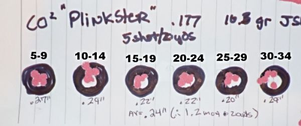

3rd 12gr. used for test targets at 20 yards. Did "waste" the first 5 shots getting the scope re-set for zero (after having it apart to get to the striker, putting it back together, did you really expect it to return to "right on" zero?).
NOPE..it ain't a match rifle.
Does seem to be accurate enough to shoot as far as I'd use an 8-8.5 foot pound .177 in anger.
