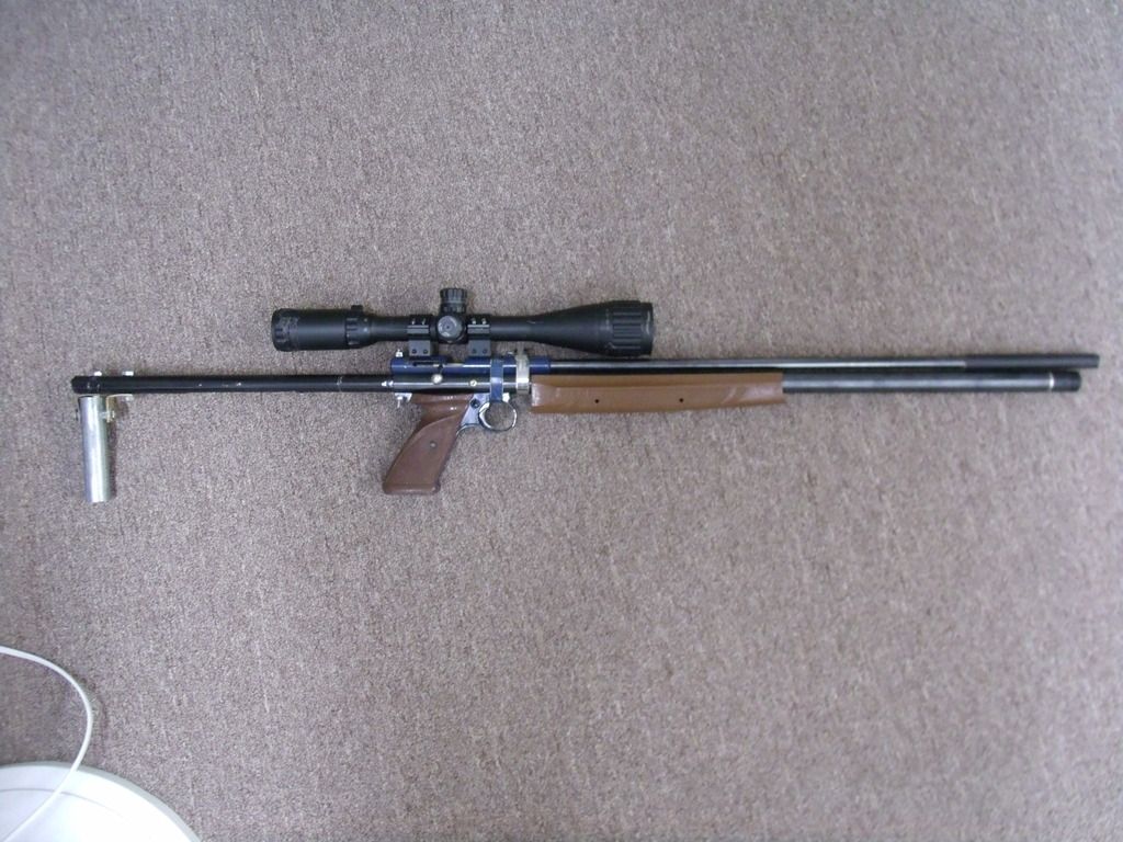

Here is the gun. I will be painting it all black as soon as it gets warmer.
Here is my original two posts with info on the gun.
http://www.gatewaytoairguns.org/GTA/index.php?topic=117753.0
http://www.gatewaytoairguns.org/GTA/index.php?topic=118846.msg1146026#msg1146026

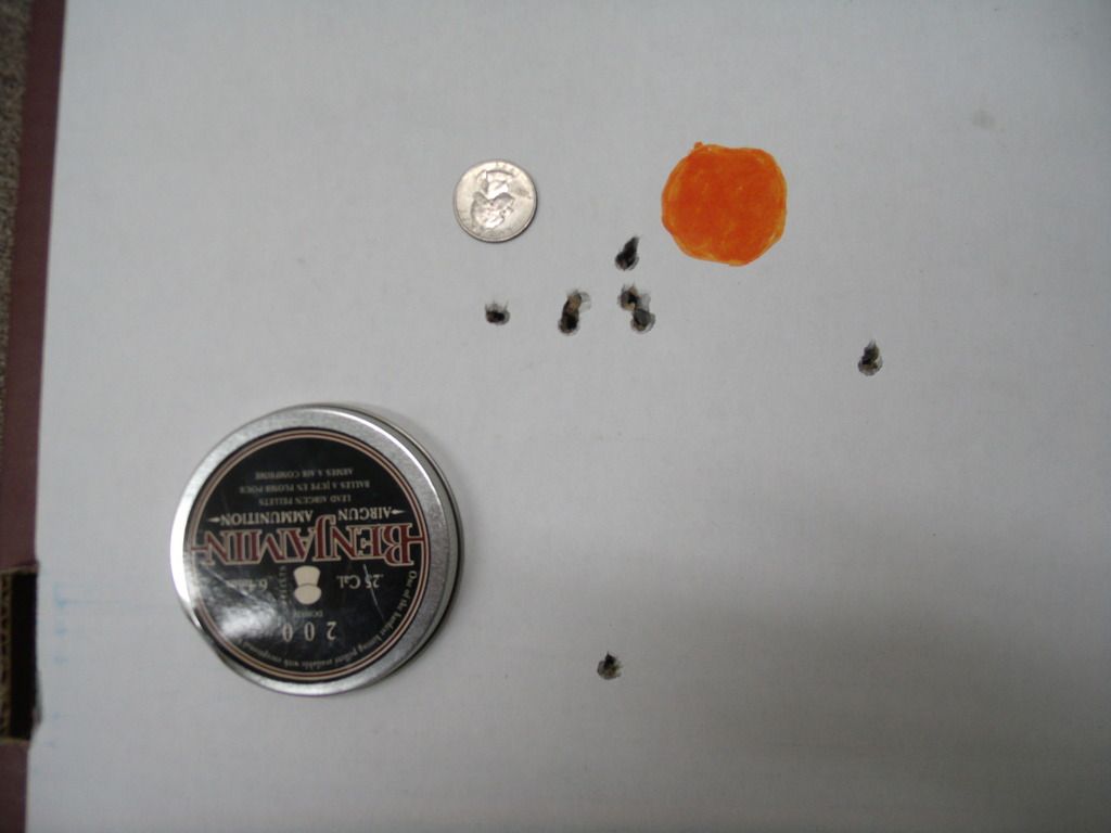

Here is the accuracy at 50 yards. The two shots low and to the right were me siting the gun in. The group has 6 shots inside 1.5". I was in a hurry so I think I can do better.
