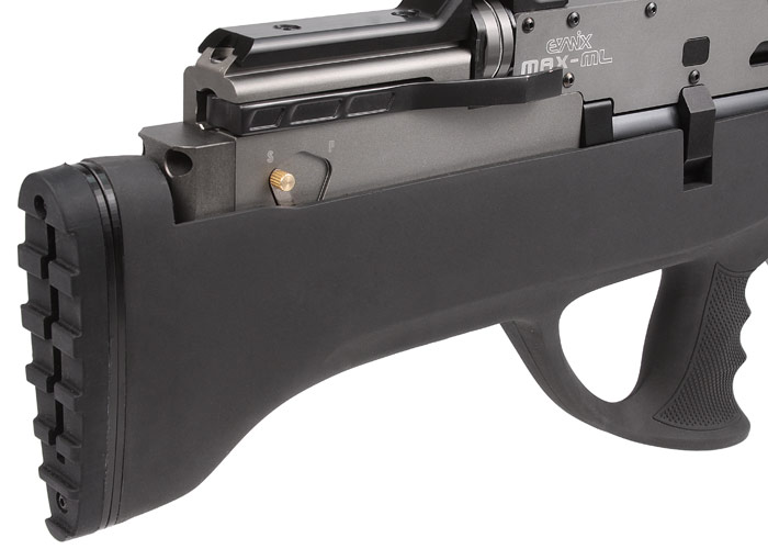

The silhuette season is over so it's time to see if more power can be had from the gun. In preparation for that I beefed up the rear of the breech. M4 threaded holes were done by the factory so this implies that the original design of this gun had a supporting bar for the cylinder where the sidelever lever holding screw attaches.I would actually recommend this mod for all 9mm Evanix owners, takes few minutes to make and beefes up the breech end considerably.
